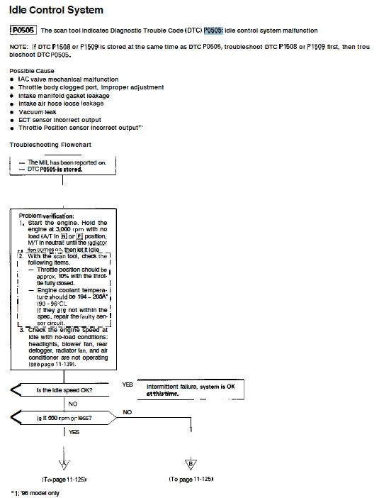

If there is an AutoZone on your way home, have them pull the code with an OBDII scan tool (free service). Otherwise, use the jumper wire method described at the link in my signature. It'll be interesting to know whether the CEL code signifies a fault with the IACV or its circuit.
Old Oct 2, 2008 | 03:55 PM
davidt222's Avatar
Joined: Aug 2008
Posts: 59
The car ran fine again on the way home and seemed to idle okay again, although it does seem to have some response issues.

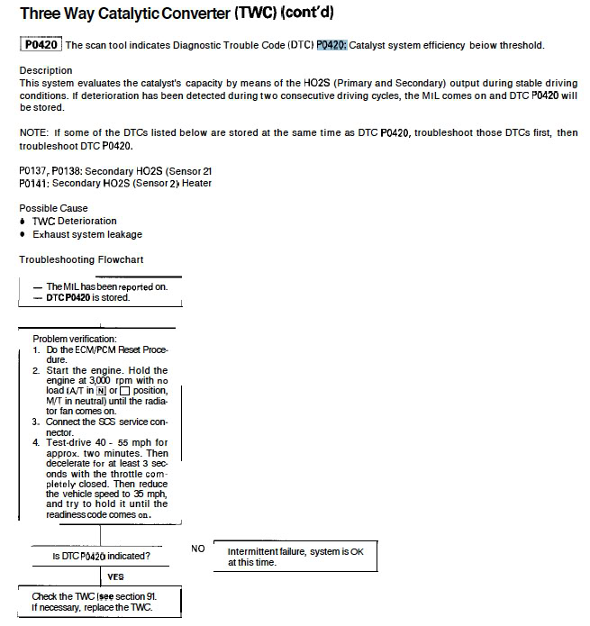

My code reader gave two codes: P0505 - Idle Control System Malfunction and P0420 - Catalyst Efficiency Below Threshold, Bank 1...
...what the heck do these mean?
Old Oct 2, 2008 | 04:13 PM

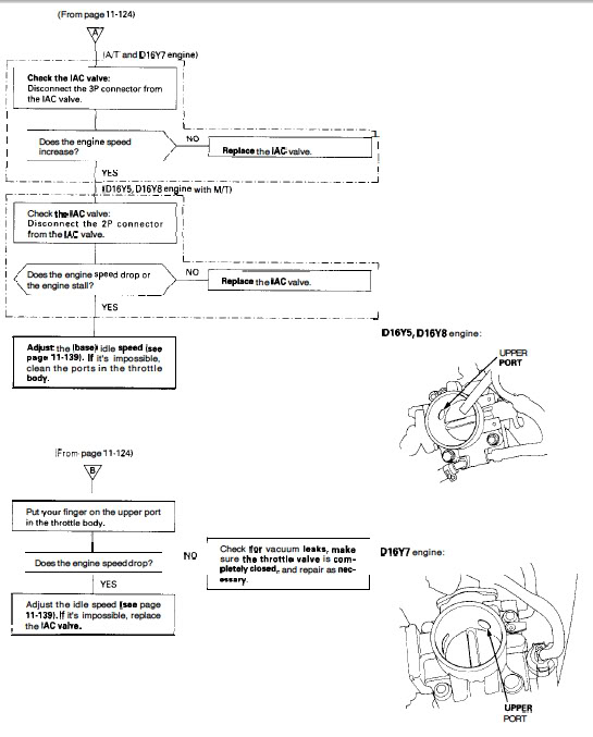

Troubleshooting those two CEL codes should identify the problems you are having:
