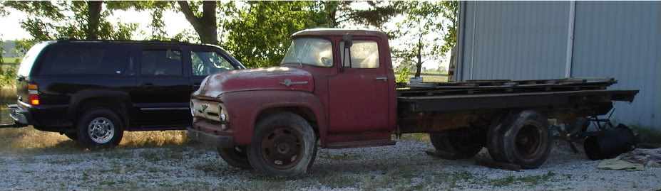

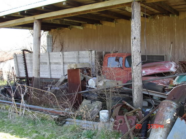

my dad has a 56ford that wed like to restore. but its huge! old grain truck that my dad drove to school as a kid hauling tomatoes from the farm.
even when i was a kid i used to climb around on the truck at my grandpas house. hell i dented in the roof myself from crawling all over it as a kid.LOL been parked for at least 30years! motors locked up and no brakes at all. i started messing with it last year and then got preoccupied. tho the motors still full of tranny fluid to hopefully brake the rings free. but if not just rebuild it or replace it with something with real power.
