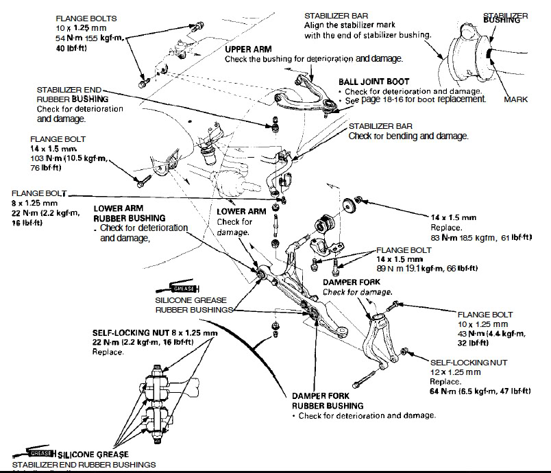

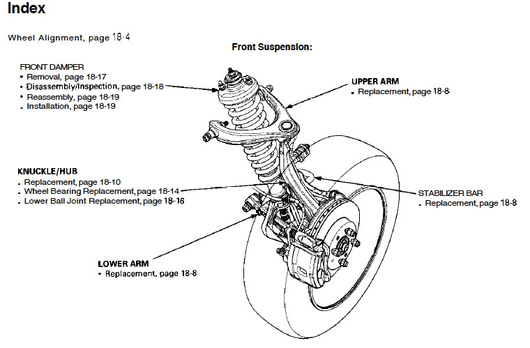

Front wheel?
Is the bar seen in the either diagram? Or is it a steering tie rod?

^i'd imagine it's the rear wheel... i don't know how you would lose control of a FWD car drift and have the front wheel hit the curb. Usually when losing control around a corner on FWD, the rear slides out and would be what hits the curb.
Old Nov 12, 2008 | 11:29 AM
codered3x's Avatar
Joined: Oct 2008
Posts: 35
its the lower arm ron ... and it was the driver rear wheel... good call trustdestruction lol
