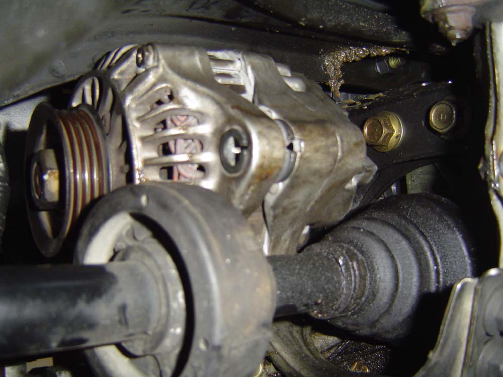

I tried to slide it towards the outside, but there is a rubber ring around the axle that prevents it from coming out. it can't get past that point...
Old Jan 6, 2009 | 09:29 AM
Try turning the wheel all the way to the right or left. Also post some clear photographs of the alternator and problem area.
Old Jan 6, 2009 | 09:42 AM
Viper42391's Avatar
Joined: Apr 2007
Posts: 10
here are a few... the alternator is resting on the axle with the ring that is holding it in in front of it.
Attached Thumbnails Replacing Alternator-dsc02551.jpg   Replacing Alternator-dsc02553.jpg
Old Jan 6, 2009 | 09:49 AM
The rubber ring is the axle damper. Rotate the alternator in various positions. It should come out by raising it above and to the left of the axle damper and then moving it toward the camera that shot the leftmost picture. Again, also try moving the steering wheel in the extreme positions, which should slightly reposition the axle. Finally, if I remember correctly, the damper is not completely rigid, allowing for slight repositioning to extract the alternator.
