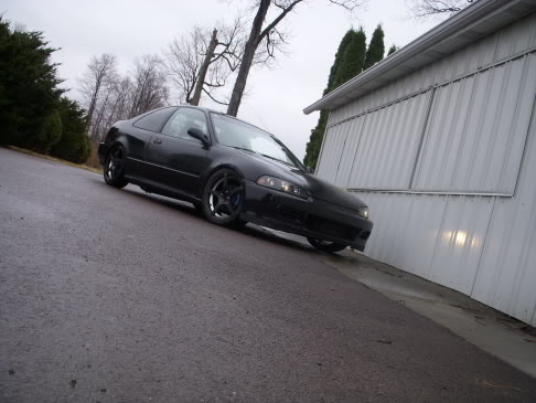

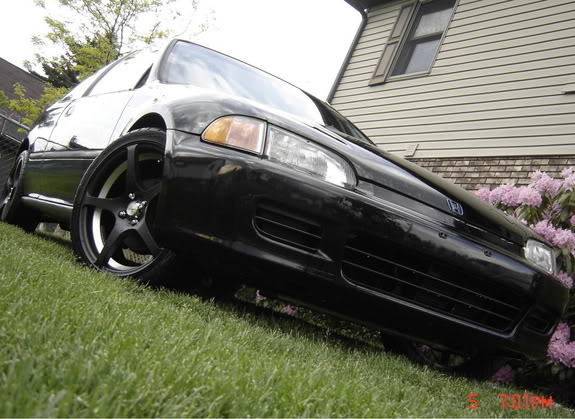

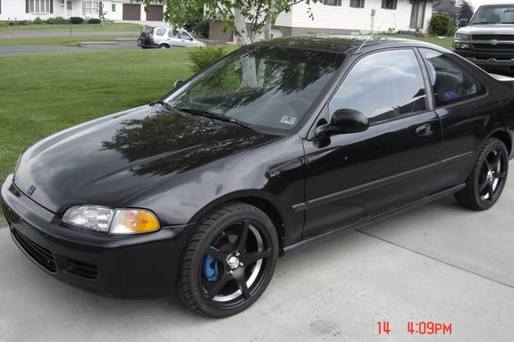

It won't really change the ride height (the smaller sidewall makes up for the larger wheel), but it'll look weird at stock height:
Vs.
Personally, I don't think they look terrible when you're slammed, but at stock height they don't look right.
