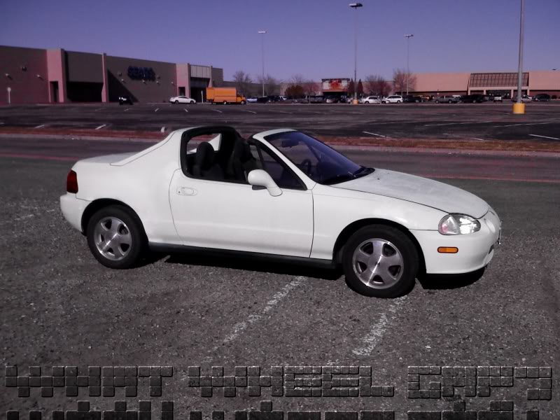

How it sites now:
Old Nov 20, 2009 | 02:44 PM
monster truck del sol ......btw you can put a back seat into the crx, the eagle talon rear seat fits perfect
Old Nov 20, 2009 | 02:47 PM
lol look at filename,
LMAO, once I get problems fixed, and get an ECU Lowering is #1 priority :P
