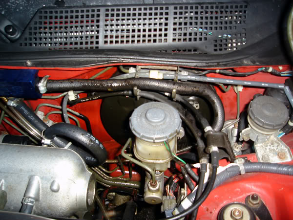

ohh another update, just bought my sandwhich adaptor, gauges, gaugecluster, and vacuum manifold!
could use some help on connecting my break booster line to the vacuum manifold?
one more thing, the break booster line is the one connecting the intake mani to the little black circle thing that the break fluid box is connected to right? lol sorry im not much of a mechanic yet.
do i cut the BBL in half, connect it to the vac mani and little circle thing on drivers side? then with the other half do i connect one side to the intake mani (already connected anyway) and the other side to the mani also? thats what it looks like i would be doing from this pic that i found of ary's when he was having hisBBL problems..
thx for the pic btw lol

anybody with tips for my break booster / vacuum mani question?

the brake booster is your thickest line. cut it before the check valve, i believe thats what its called, then connect the shorter end that goes from yourintake mani to a port on your vac mani. then hook up the longer end to the side of your vac mani.

so basically, do exactly what your picture looks like thats a ton easier than i was thinking it would be.
one thing though, what and where is the check valve? i saw nothing like a valve on my BB line. or am i just being dumb
thx a lot for the info

lol to be honest i was wasted when tony did mine so i dont remember. i htink just as long as you cut it down towards the intake manifold so you have a little left to hook up to the vac mani. you might want to call soviet on that one.
