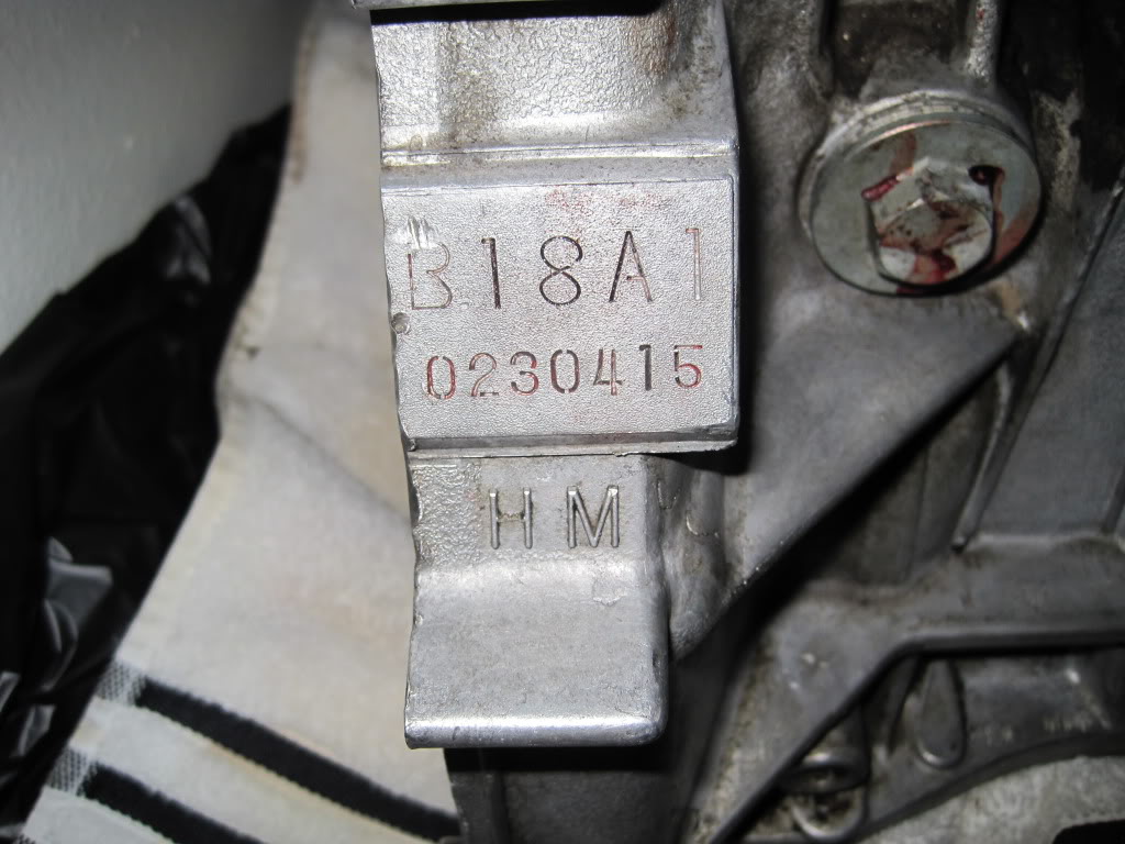

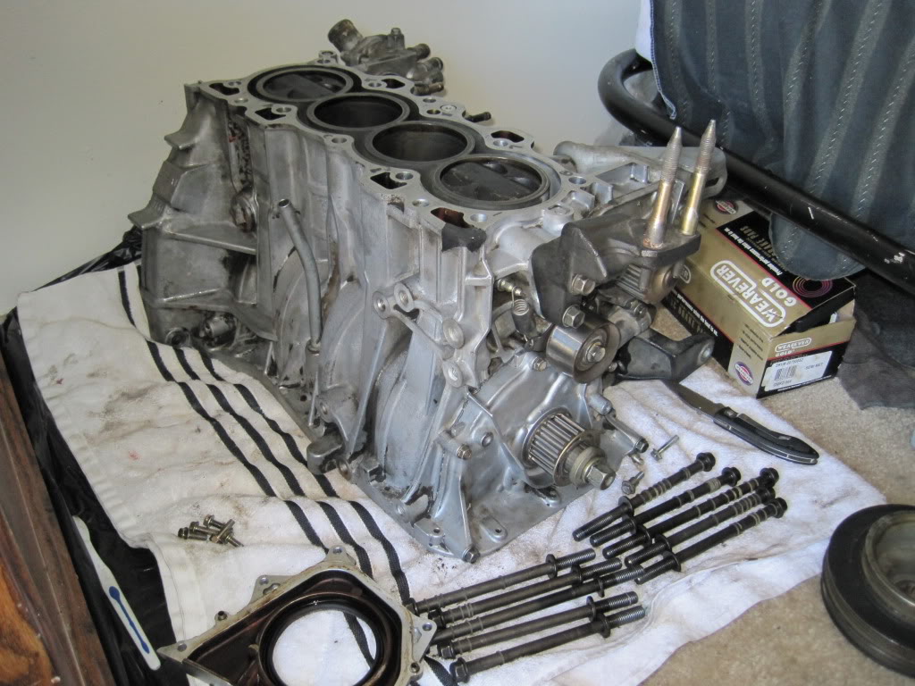

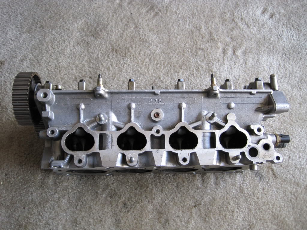

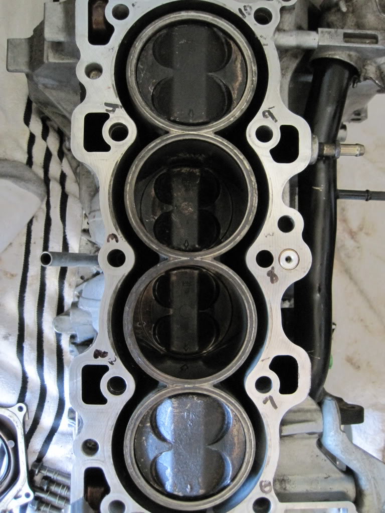

PR3 Pistons
here is the ls head, off a 98, the P75 you see i believe is the ecu code for the head? correct me if im wrong
