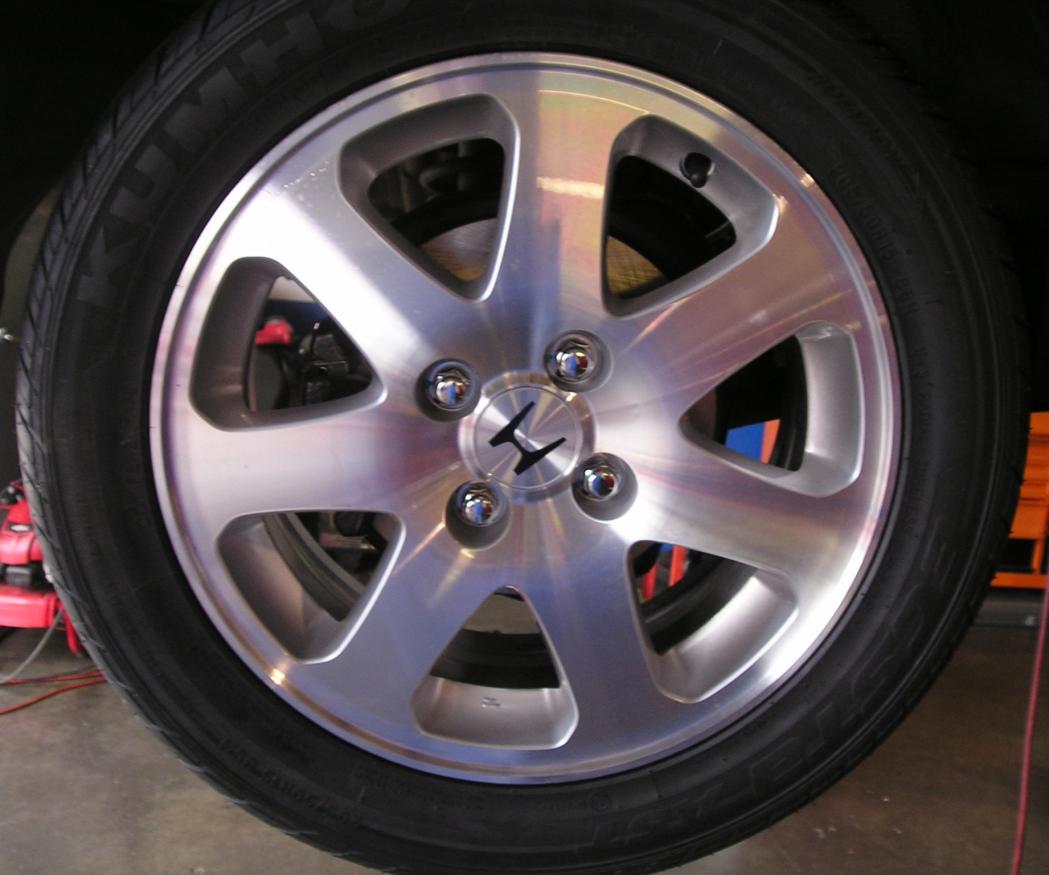

The rear disc conversion is finished. Painted the trailing arm assembly, added new rotors, new calipers and stainless steel braided lines. I am pretty happy with the outcome. Also, add some LCAs while I was at it. Here are some pictures.

Attached Thumbnails Hybrid HX-left-side-lca-.jpg   Hybrid HX-right-rear-insde-finsihed.jpg   Hybrid HX-right-rear-finished-wheel.jpg
