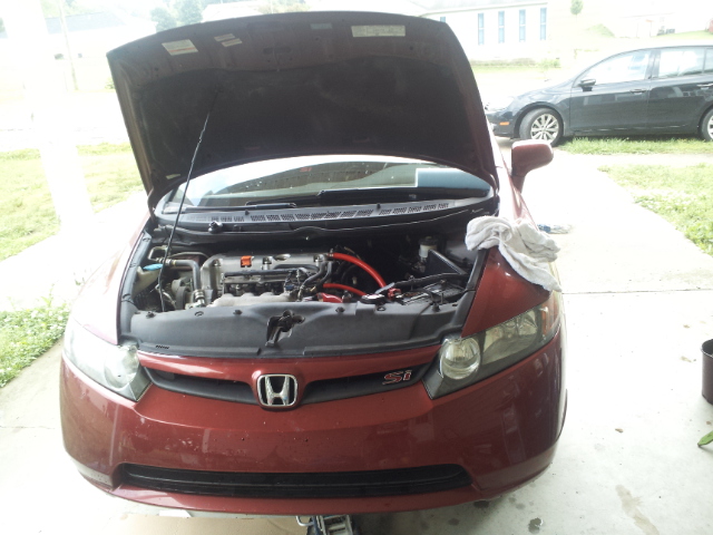

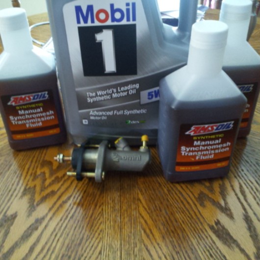

Got to spend a small amount of quality time with her today. New filter and Mobil 5w30 synthetic oil change. Trans fluid replaced with Amsoil 5w30 Synchromesh synthetic. Few busted knuckles and driveway stains. Fixed my Stang and my Dad's commuter this wknd as well. On to pics...

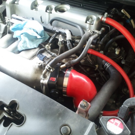

Skunk2 72mm tb and some ****e silicon stuff^

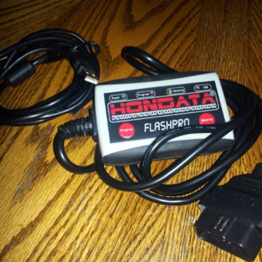

My CEL is on because I havent disabled my secondary o2 yet. Flashpro be hard yall.

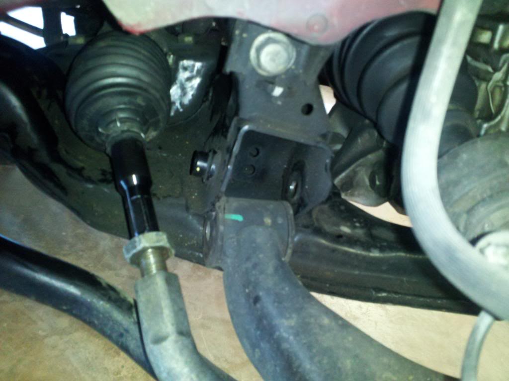

So, my ****box has been giving me fits. Front end vibrations, alignment wonky, diving under anything more than moderate braking. Replaced pads, rotors, inner tie rods...... to no avail. On my way in to work monday and the pass front snapped to the ditch, almost flipped. Called the wrecker, had it towed to my Grandad's shop. Finally got under it today, and I find that THE MOTHERLOVING LCA BOLT HAS VANISHED. HOLY SHIZ. I COULDVE DIED. Anywho, Honda disillusionment sets in. Time for a photo dump.

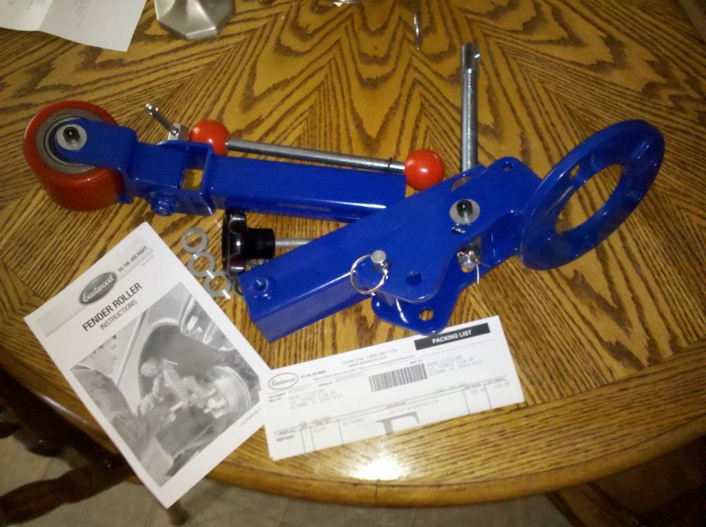

MY new eastwood fender roller

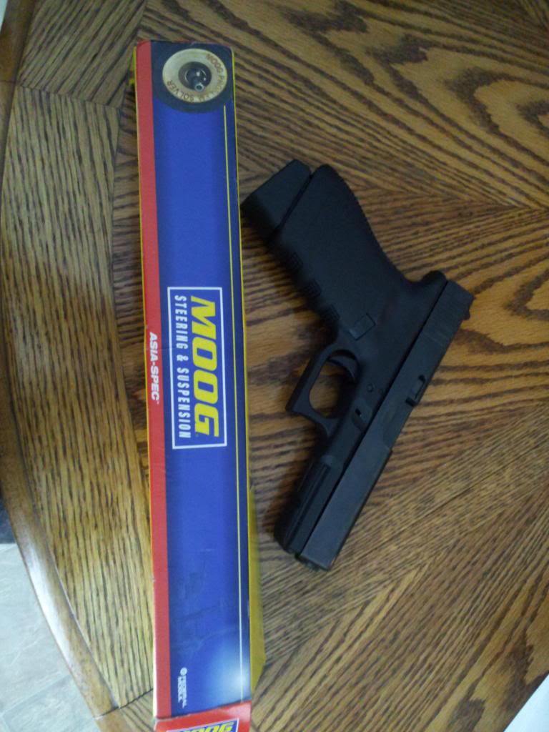

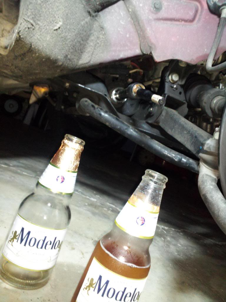

New tie rod end, the Glock 20 is just to liven up an already dismal photo.

new tie rod end installed
HOLY JEEBUS, LCA bolt gone. Source of my problems.
Gonna order proper bolt, install lowering springs, and finish rolling my fenders this wk. Also going to install NGK Iridium plugs. TLC for the mother****er that tried to kill me.
