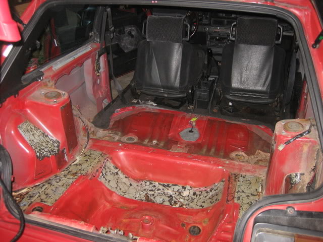

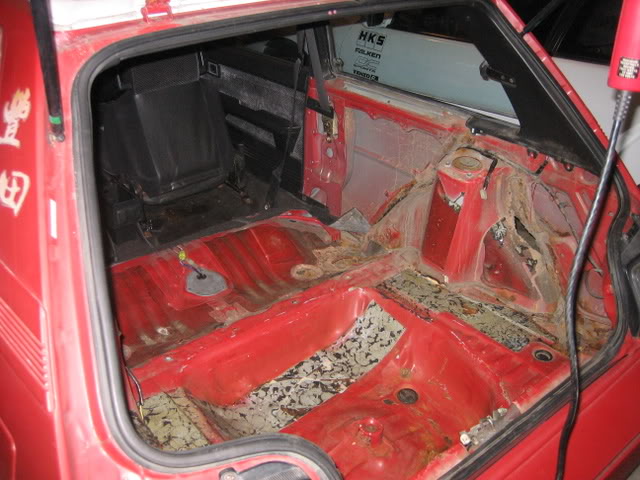

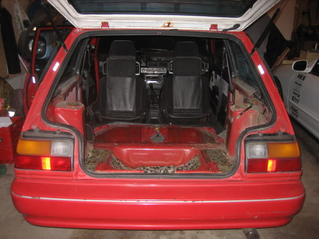

we stripped out most of the sound deadening in the rear. was holding in moisture and dead weight.
also stipped the rear interior. we'll probably leave it stripped because we'll be welding in alot of metal and supports.

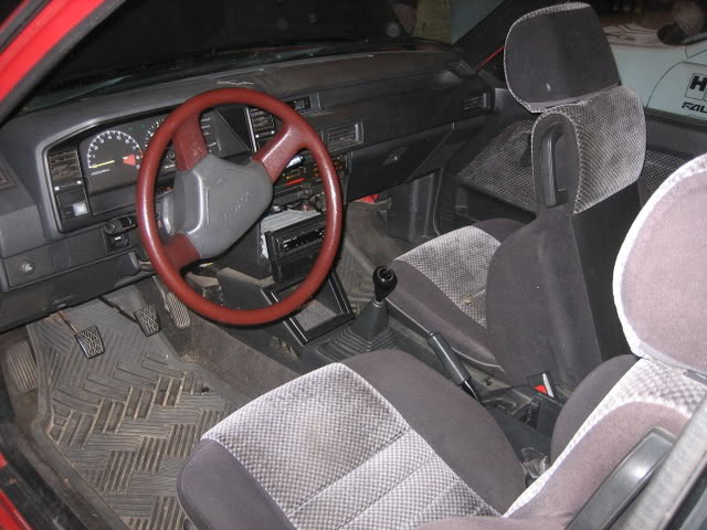

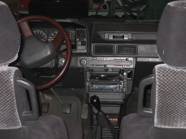

front interior, pretty clean.

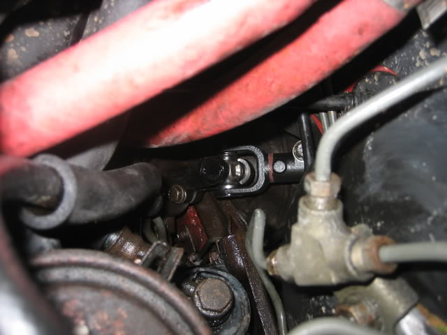

new joint

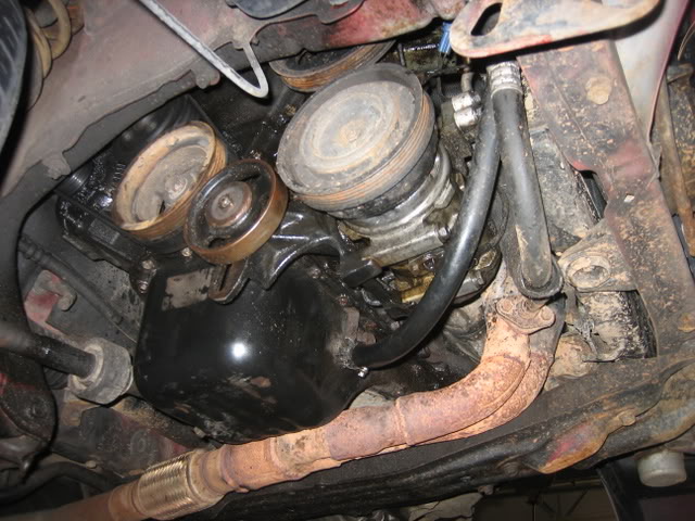

after some cleaning

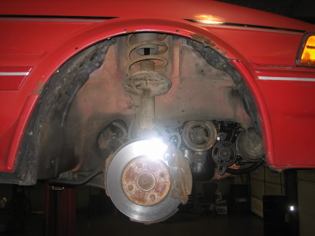

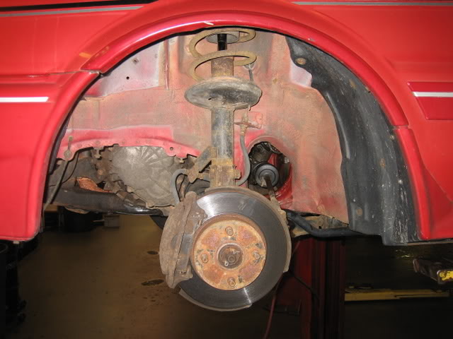

driver side front suspension
passenger side front suspension

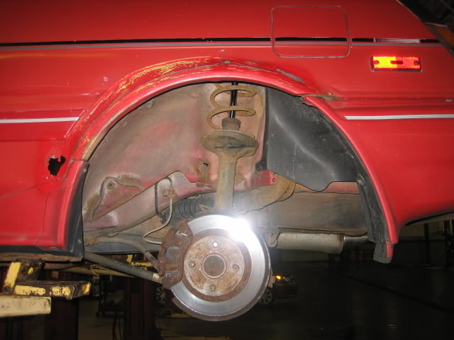

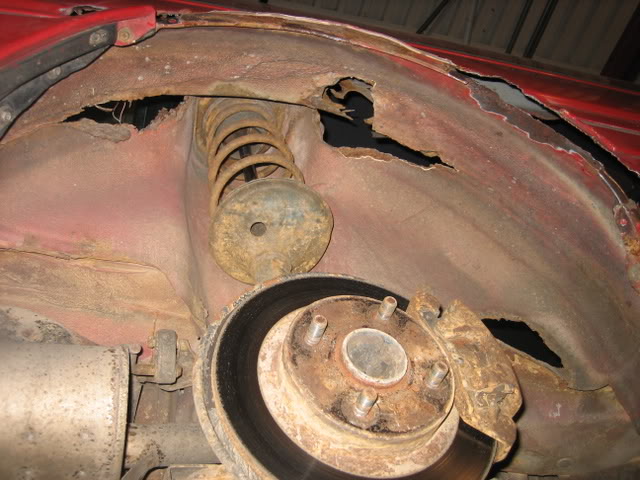

passenger side rear suspension. the holes are left from removing rust
driver side rear suspension

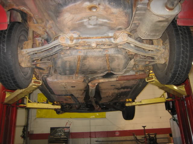

undercarrage is alright. bit dirty but dosnt seem bad.

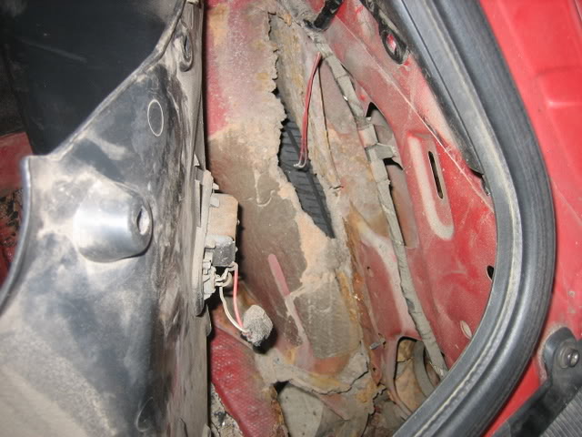

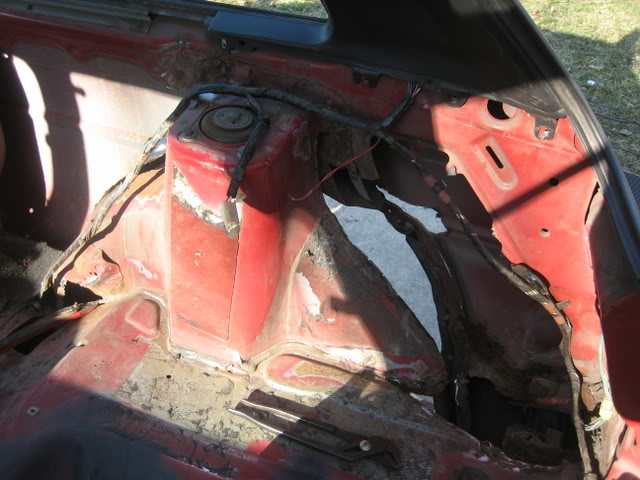

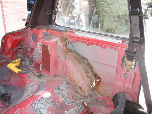

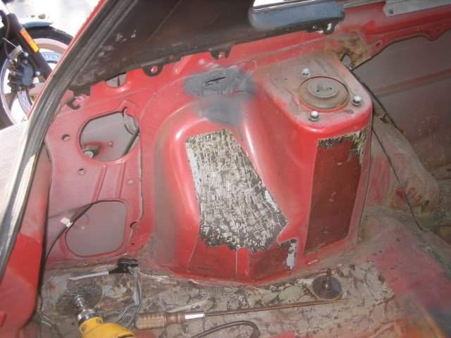

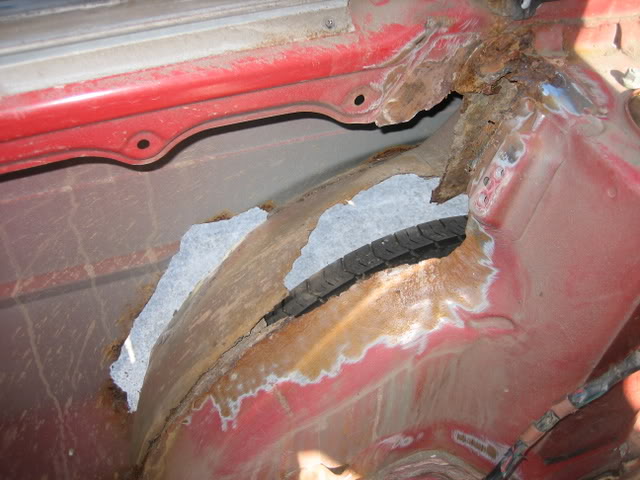

not tooo much has gone on since the last update. we've removed a sh*t ton more rust/metal from the rear to get it ready to weld in new metal. hopefully we'll be able to get the new metal welded in within the next week or so.
here pics from a few days ago. since then we've removed some more rust..

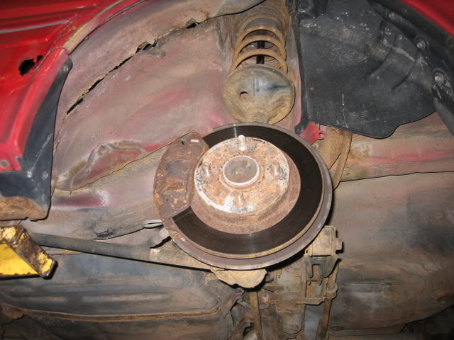

driver side rear suspension, what the passenger side SHOULD look like..
aaaand the passenger side

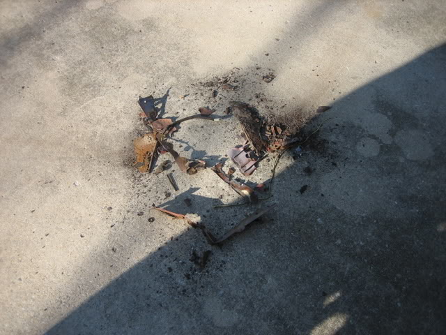

stuff that fell outa the car.. thats just some of the junk

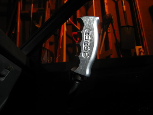

and our first mod! Hurst ****, feels f*ckin great! real comfy

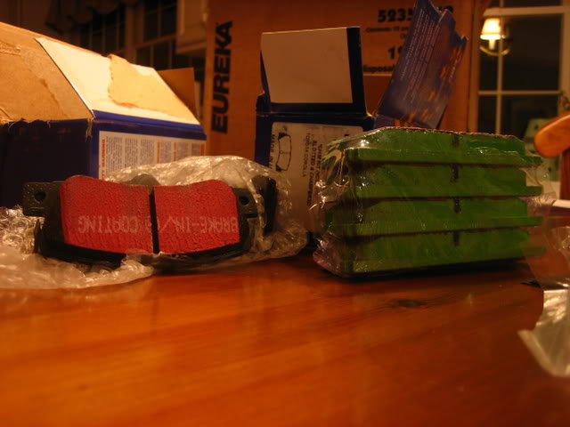

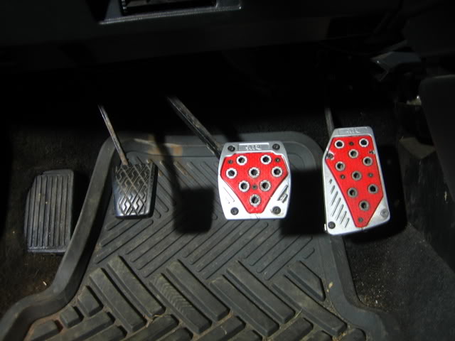

brake pads came in the other day. EBC GreenStuff for the fronts and EBC Ultimax for the rear. Also put on some pedal covers for easier heel-toe, should be pretty useful since theres a good amount of downshifting to 1st gear in rallyx.. co-driver also cut out a pretty large chunk out of the driver side rear fender.

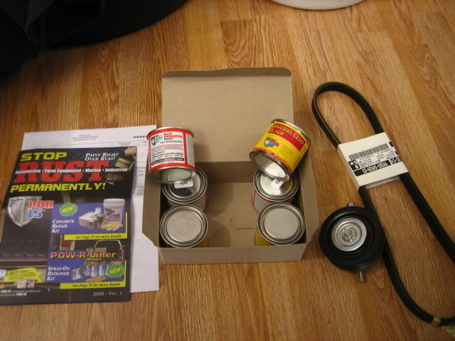

last week we ordered POR-15 rust preventative paint, KYB GR2 struts, and SP Performance slotted front and rear rotors. i have a new powersteering belt but i ordered a new tensioner pulley that im still waiting from my dealership to get. once we get that, the belt will be installed and i'll flush the system. searching and ordering parts for this car is a bit of a headache. all the parts i order from my Toyota dealership have to be shipped from Cali and most will probably be on back order. luckily shipping dosnt take very long and they take care of me since im an employee. probably gena pick up some new metal this week and start prepping it to be welded.

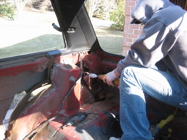

anyways, the power steering tensioner pulley, brake rotors and the POR-15 paint and top coat came in today. dont have pics of the rotors yet since their at my co-drivers house. i believe he was going out to pick up some metal tonight aswell, if not tonight atleast sometime in the next couple days..
