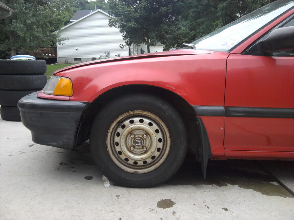

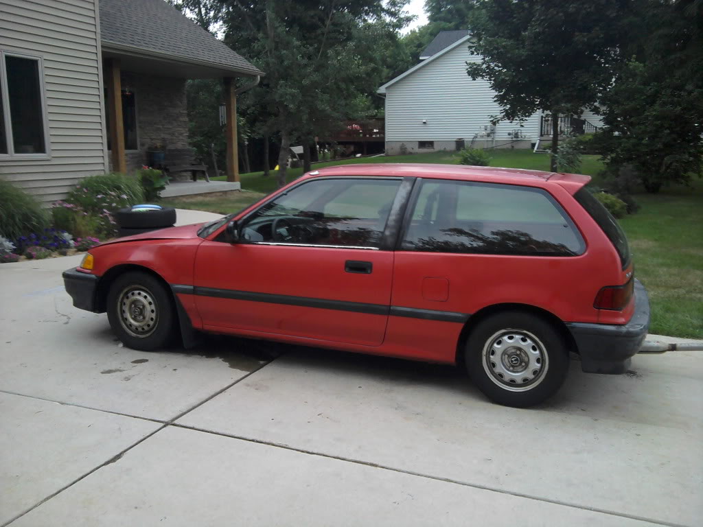

ok so a little update. my friend has been convincing me to go f20b. upgrade some internals (pistons, valves, springs, head gasket) to get a decent compression out of it. around 12:1 or 13:1. also increasing the red line from 7600 to 8000-8500. then he said to get a f to d plate for the transmission because d series transmissions can take a lot of beating... or that is what he said. if someone can confirm this it would be great. he said the gears are "stubby" whatever that means. so i can stick with my cable driven clutch... or i think i can. he says get a transmission out of a 97 civic ex or something like that. he said i could push up to 300 hp pretty easy. now its just about getting the motor in the car. this is where pics come in.
so first off i lowered the car. here is some pics.
so i like the look of it a lot. i still think there is a tiny bit to much wheel well spacing. maybe 14 inch or 15 inch rims. nothing huge, just something to cut the gap.

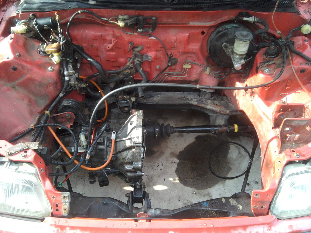

so now we move on, with the car looking cool i have to replace the engine so i guess ill take everything out of the engine bay right?
so that is one day of taking stuff out of the engine bay. i should get more out thursday.
