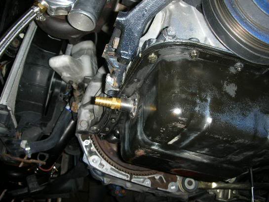

Tyler I might be worried about that oil return flange, its not really bent up so the oil might have a hard time getting gravity fed back into the pan..........

ORIGINAL: Pete
what do you mean? show me from the picture

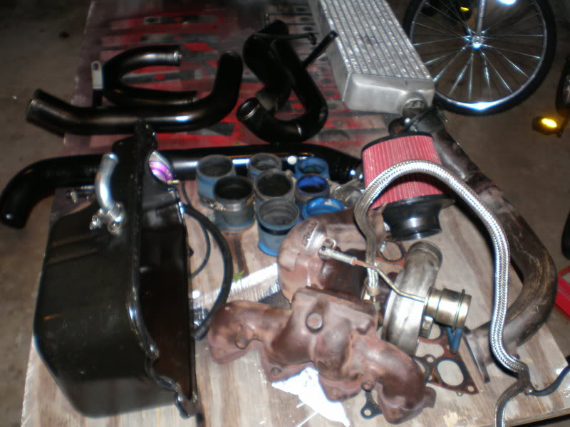

See how the one youve got isnt angled, whereas the one on my old oil pan was kinda angled up. I just hope that yours will be able to get the oil back into the pan fast enough

the oil drain line will be fine. the drain hose needs to be cut down to produce a good drain angle. the turbo actually sits pretty high so that shouldn't be a problem. the biggest problem is going to be not maxxing out the dsm450's i think.

Yeah that drain should be good considering the turbo sits really high. There are lots of little things like that, that just need to be wrapped up. It's going to be a beast this spring
