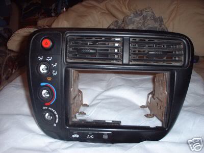

So are you planning on switching to the 99-00 Civic climate control thingy? If you do, you need to switch out the entire heater core etc as the 96-98 have cables or w/e and the 99-00 turn style ***** are electrical. Some one correct me if I am wrong.

I am gonna get the 99-00 dash and climate and change out all the heater crap, then gonna order everything i need and wait till i have everything i am gonna do so i can take my car all apart once (knock on wood) instead of a little bit at a time for different parts.

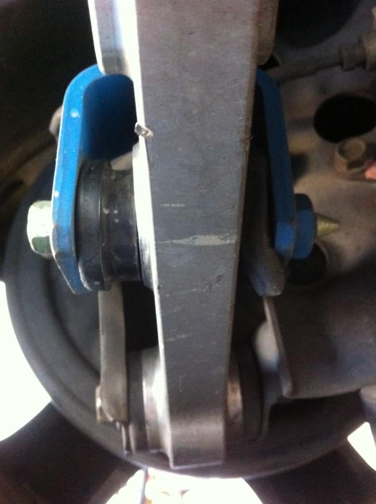

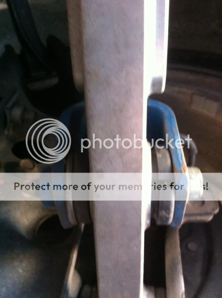

So these are my lower control arms bushings....
and a very bad video
http://s436.photobucket.com/albums/q...t=IMG_0071.mp4
They have been in for less than a year, they may have not been torqued perfect, but due to the major damage being to the shock mount, i am convinced it is poor quality bushings. Skunk2 would not replace them or anything since i didnt not have a actualy receipt, just payment records, since i bought it from ebay (-.-) but i have the warrenty cards and everything, anyway i wish i had gotten the function7s but alas it does not matter, i will just get energy suspensions and a sway bar soon.
heading to the junk yard later this week to pick up heater core and 99-00 dash harness ect, also ordering roof lining tonight along with a few pc parts.
Sorry to hear about the bushings. I think I need to go check mine now. Did you preload the suspension before tightening the bolts and lowering the car? I also used some silicone lubricant between the bushings and the shock collar/trailing arm/sub frame.
I used silicone to get the bushings to fit. Even then they were soft and wanted to rip easily. But i didnt have a torque wrench
so i just made them snug in the air, then lowered car and made them a little tighter. Anyway i will order new ones and get a torque wrench this time.
