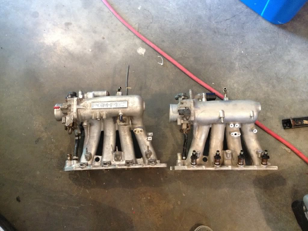

And, damn, I installed that ITR manifold... big difference compared to whatever was on there before.
this is the "BEFORE" picture. i've been too busy enjoying my car to take pictures lately.

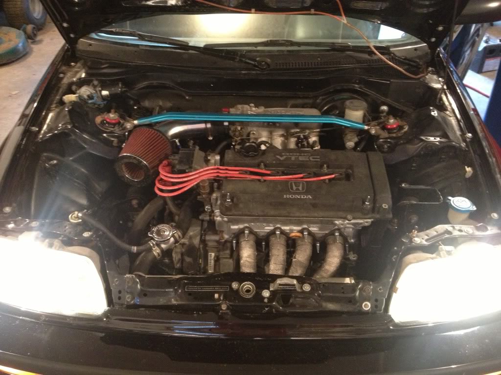

My tires spin when I slam it into second. Well... they hop.
And, FINALLY, Explicit Speed Performance emailed me and said my traction bar has been shipped out!!! Woop! I can't wait.
