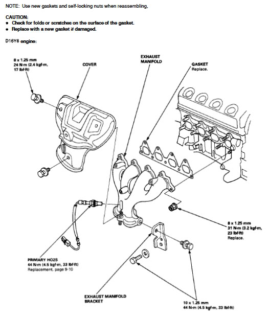

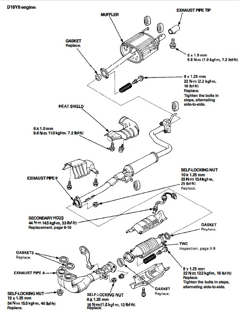

Originally Posted by GReddy_Civic
or switch to an EX exhaust
OP: If you live in Pennsylvania, it sounds like Greddy may want to negotiate a deal for his EX exhaust.
Greddy: Does the conversion involve simply replacing the exhaust manifold and exhaust pipe A with the EX exhaust manifold and cat?
Old Oct 20, 2008 | 04:59 PM
ya to change to the EX exhaust i believe you also need a O2 wire extensions to move the lower O2 sensor to behind the motor around the EX cat.
i havent done this swap yet BUT i want to my dx!
Old Oct 20, 2008 | 05:24 PM
The picture I posted shows that the O2 sensor of the 96-98 Y8 exhaust is forward of the engine, similar to that of the Y7 exhaust. Nonetheless, my 00 EX with a Y8 has an Si exhaust where the O2 sensor is behind the engine, as you mention. I guess it depends on what type of exhaust system Greddy has.

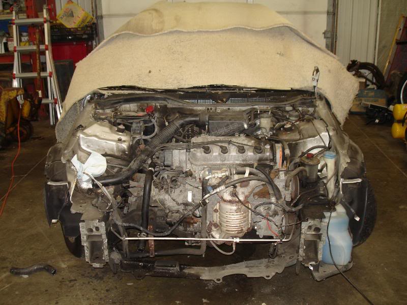

theres 2 sensors on the front of the DX.
one ontop and one on bottom of the cat.
Old Oct 20, 2008 | 05:52 PM
Gotcha, it's the secondary O2 sensor that needs a longer extension wire to reach behind the EX cat. My 00 EX (Si) exhaust has the primary and secondary sensors behind the engine.
