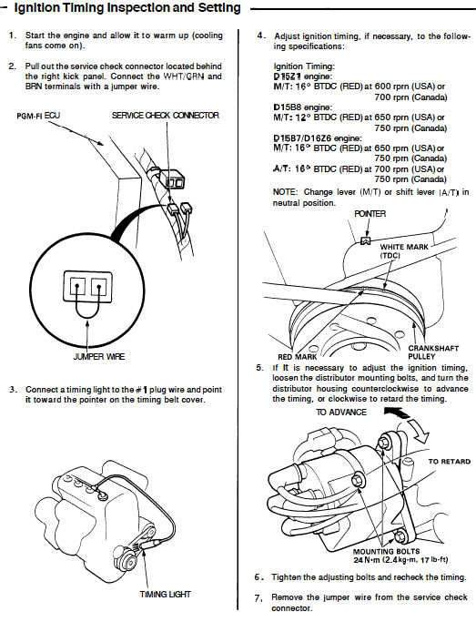

Is the CEL ON?
Have you checked the ignition timing with a timing light?

This was the same thing the guy told me at the shop today. If the timing is off, should I look into getting the belt replaced? I tried to take the cover off to see if the belt was worn, but Idont have the right wrench to get to one of the bolts. Also no CEL. If I do have to replace it, how much does it run for a shop to do that? Thanks for your help.
Old Jun 23, 2008 | 08:27 AM
Default RE: Power loss because of Cat. Converter?
If your engine has the original timing belt, then it should be replaced. When a timing belt on a Civic engine snaps, major engine damage can occur. When you replace a timing belt, replace the water pump and tensioner at the same time, as well as the spark plug seals and bolt seals in the valve cover. In addition, if oil is leaking from around the crankshaft, the front main seal should also be replaced. At the Honda dealership, I think this work would cost approximately $500-$650.
If the timing belt is fine, just set the ignition timing to spec with a timing gun. As shown in the diagram, this is a pretty simple procedure that you can do yourself.

Thanks for the info. I will keep you posted. Also thanks for the manual. I downloaded it and it is a great resource.
