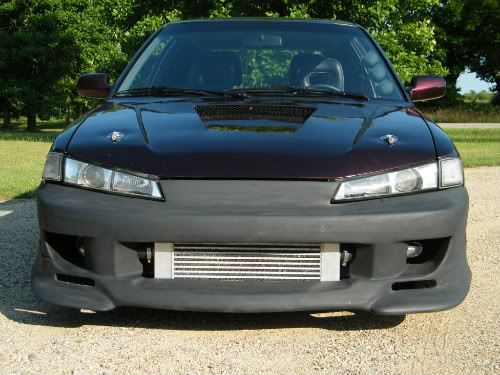

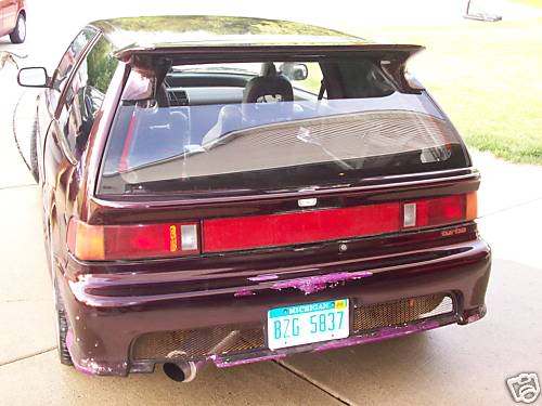

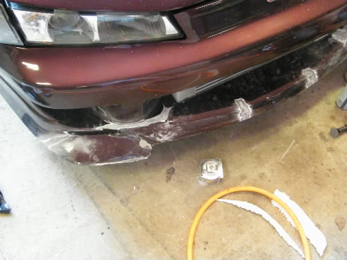

This is how the front end was when I got the car.

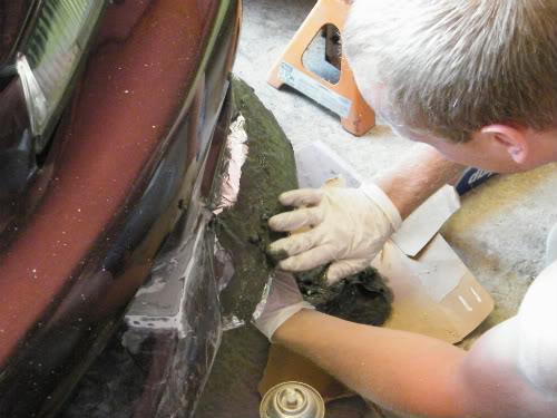

And I had to change that. The guy I got the car from gave me the broken piece of the front end but it was still missing one side. I had to fabricate that from scratch.

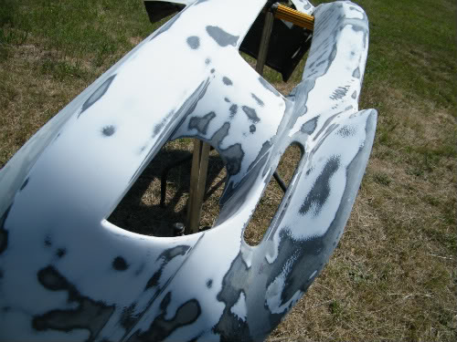

The piece he gave me(it was broken in multiple places)

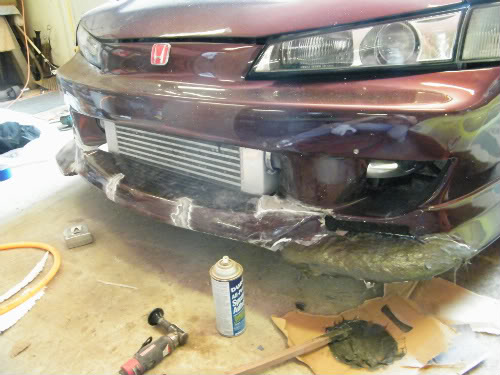

Starting to make the other side

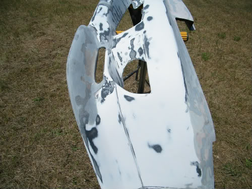

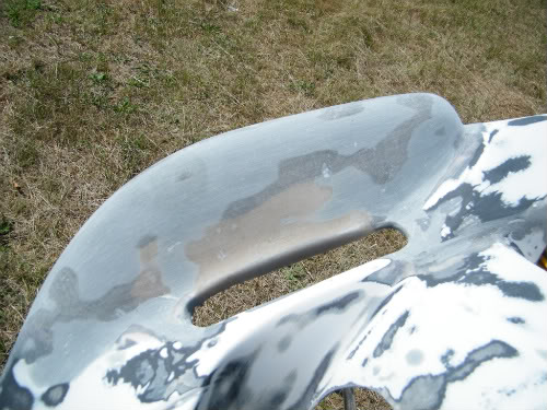

Couple layers of glass and some filler to smooth it out

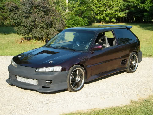

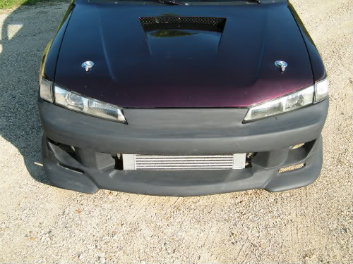

Threw on some flat black before a cruise in. Still needs some tweeking, smoothing, and sculpting but I think it is much better.
