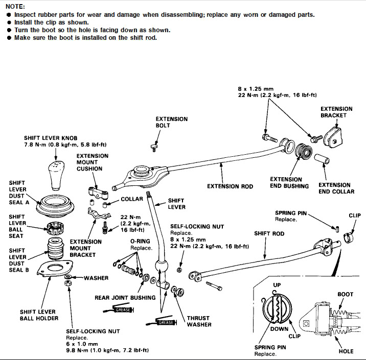

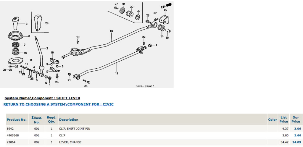

If you decide to replace the shift lever, the diagram below should help. A replacement lever goes for $25 at Majestic Honda (without shipping and taxes) (diagram 2) --- http://www.hondaautomotiveparts.com/

Old Nov 8, 2008 | 05:54 PM
Originally Posted by 315 Customs
ron do you like have alldata install on your computer or something lol
Nah, just the downloadable manuals found at link in my signature. They're all bookmarked with chapters so it's actually pretty fast to pull up diagrams.
