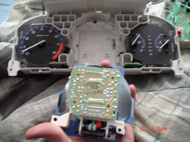

well not sure about the 94s..... but i know the 96-00 gauges can come apart.... and then you can just switch the bad parts... that way you keep your milage correct!
check the back of the gauges.......... if its got some screws like in mine... take them out after pulling the front of the bezel off and HOPEFULLY they will be like my newer civic and swapable

JUST DO NOT TRY AND TOUCH THE NEEDLES......... THEY SNAP VERY EASILY AND ARE "NOT REMOVABLE!"

alright thanks for that info, I think the 94 are like your car as I removed the mph tach for km/h with my milage. the only problem i will have now is finding a fuel gauge to swap, my old cluster does not have that small gauge design, it has a large fuel gauge, im thinking ill put that one back in and buy a coolant temp gauge for my car, an aftermarket one, as i dont want to spend more $ on another cluster! thanks again

well if the temp and fuel gauges are in one chunk like that they wont be swapable..... cause the needles arent removable....
