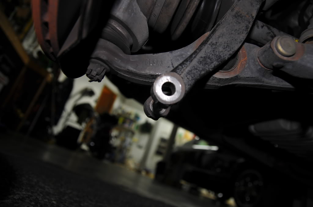

Okay! . The arm was jacked up to ride height. The bolts in the engine bay were then undone. slowly lowered down. then the wishbone bolt undone. then the LCA done. I took the LCA bolt out and BAM it came down like this.

now. THIS WILL NOT go up far enough to get the wishbone off. It is about impossible. If you can help PLEASE do so =)

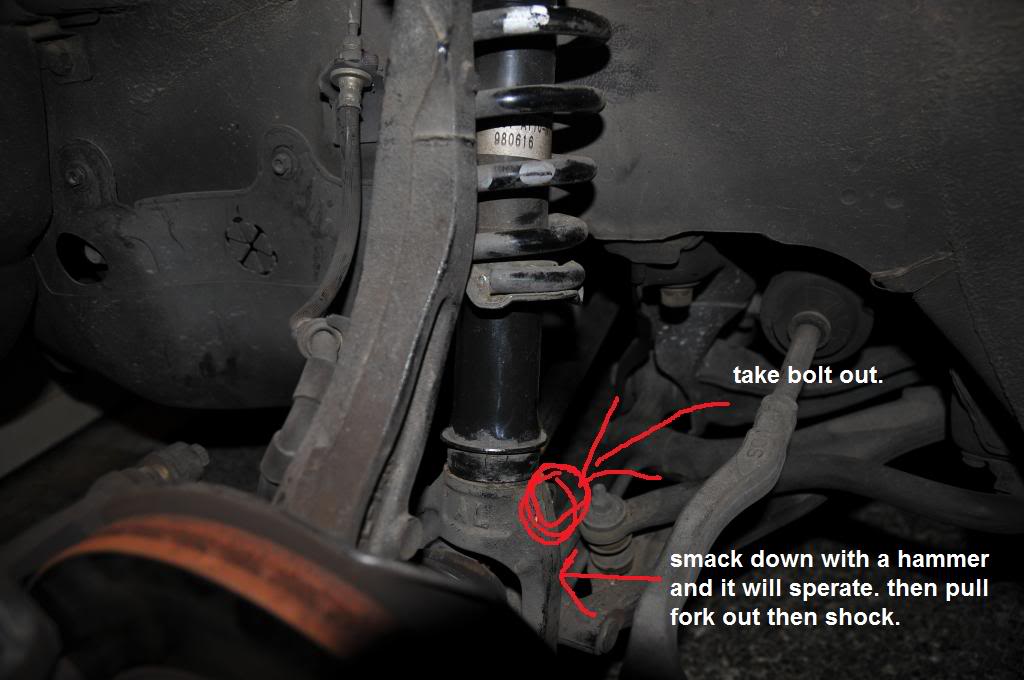

Remove the bolt that holds the fork to the strut assembly.
Old Sep 15, 2009 | 08:16 PM
brajj's Avatar
Joined: Jul 2009
Posts: 291
the bolt that is behind on that wishbone thing - that comes down??? I did remove that.
Old Sep 15, 2009 | 08:18 PM
danomatic93's Avatar
June 2010 ROTM
Posts: 3,284
From: Milwaukee, WI
