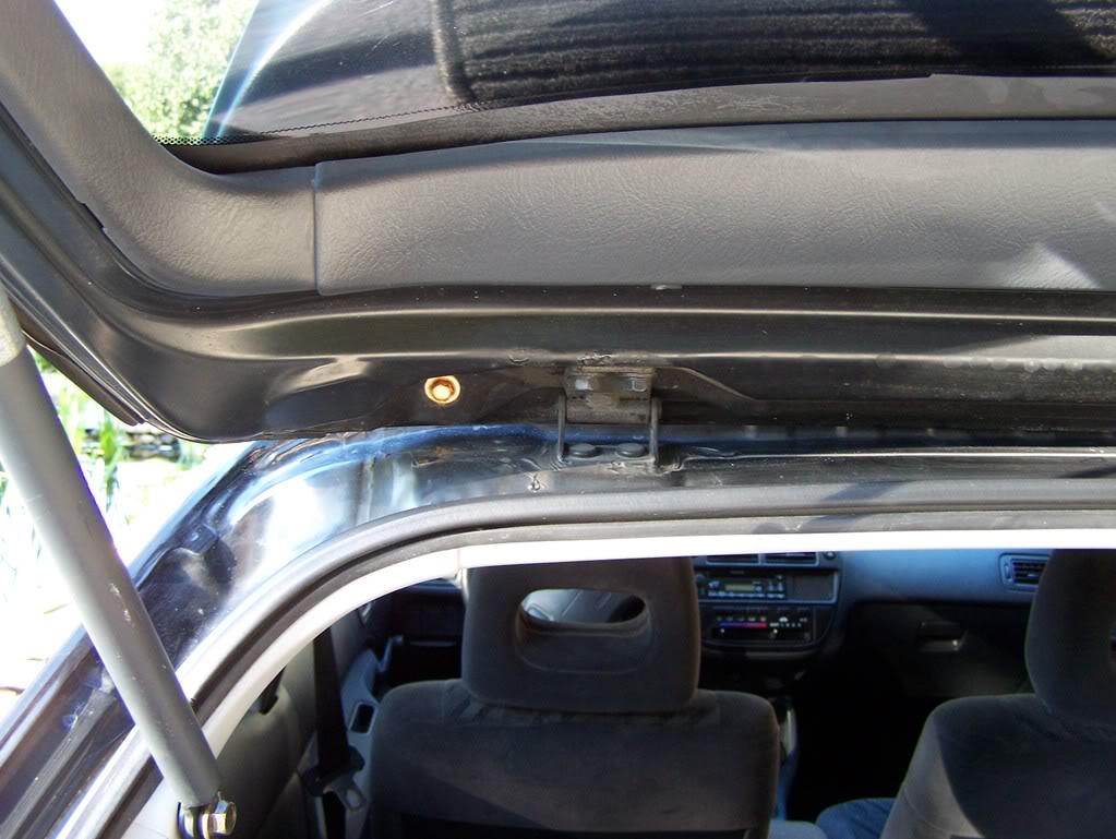

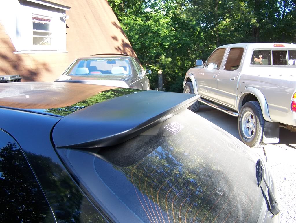

lift up the hatch and it should only be 2 10mm bolts in either side of the upper part of the hatch lid. see pics. Mines a 96' too, but I got some cheep ol' spoon copy spoiler.
