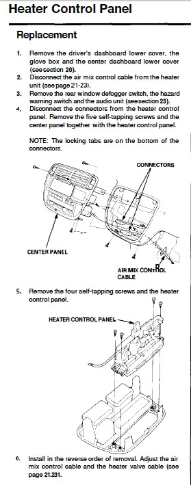

If all the instrument/gauge lights don't work, then check whether fuse 30 is blown or whether the dash lights brightness controller is bad.
If the problem is limited to lights in the heater control panel, then the bulbs are probably burned out. Here's how to access the bulbs:
