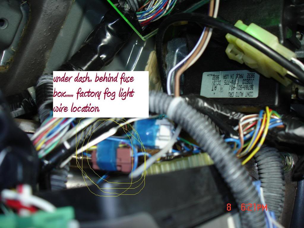

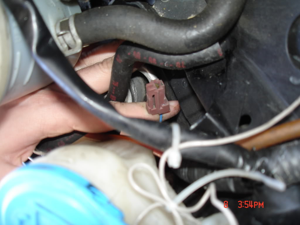

The connector is by the Water reservoir bottle, below it(windshield fluid) I just did my 00 Si and the connections are the same for your model.
Here I got this info Thanks to Addiction
This located below the water reservoir tank for the windshield fluid and below the power steering bottle

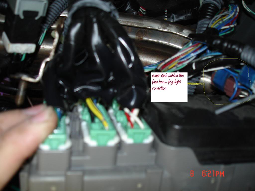

thats the wire under the dash to connect to....
then the next is under the dash....
THAT SHOULD DO YA.... at least for OEM fog light instalation....
the other light harness is easy... just take the under-steering wheel cover off and unplug the headlight harness... plug in the OEM harness that goes between that conection... and run the relay over and use the longer bolt to secure the included relay....

o ya beat me to it
ya hardest part with the foglights is finding those 2 wires! which was why i took pictures of them.

if your foglight wire harness will not plug into that harness in the engine bay then you dont have OEM foglights!!!!!!
the oem foglights has that one conection up in the engine bay, and the same style inside the car behind the fuse box, and one larger harness between the headlight switch harness. then it was just the switch conection and the relay conection...
those pictures above are the ones i used with my instal in my 99. i took 2 pictures of the under the dash harness conection.
tho you can custom wire up your own foglights and fit them any how you want its just alot messier!
