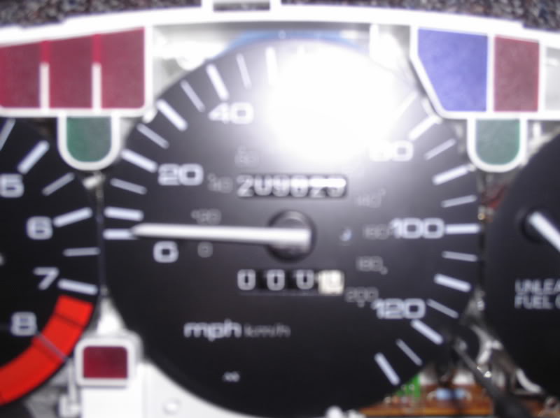

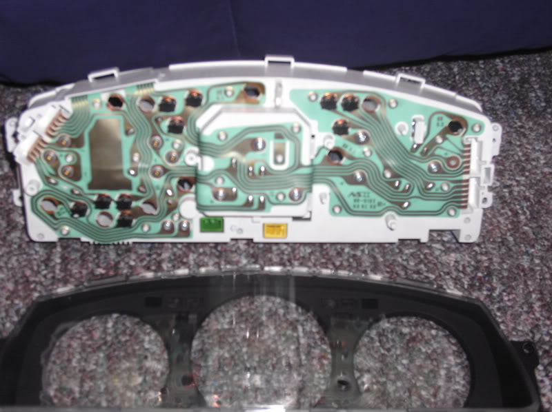

which? The first option, all you have to do is ask. They second, well. I may be easy. Since you already know how to take out the cluster you've got one part done. Now you have to get to the speedometer.
Here's how a 92-95 cluster works. First take off the cover.
Then remove the speedometer's two screws
On the back there are screws that hold the speedometer stuff in place. Take 'em off.
Now, if the whole speedometer portion doesn't come out, you'll have to pop the needle off. WAIT!! Be very careful when doing so. You might mess up the speedometer's reading if you put if back on wrong.
So, you have it off. Now swap 'em, put everything back together and you're done!
