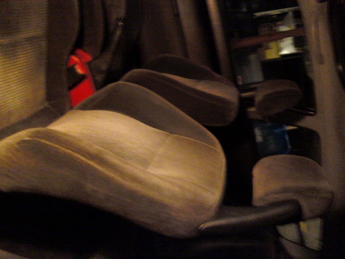

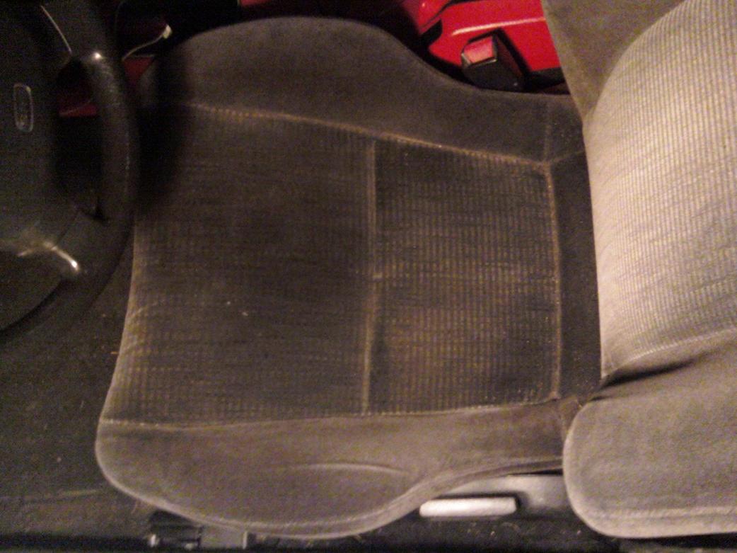

these are my seats, anyone know what will fit?
Old Nov 6, 2009 | 12:19 PM
94-01 Integra seats are direct bolt in. IMO you should stick with a solid color on seats. Look for some black GSR seats. I have 98-01 GSR leathers and I love them.

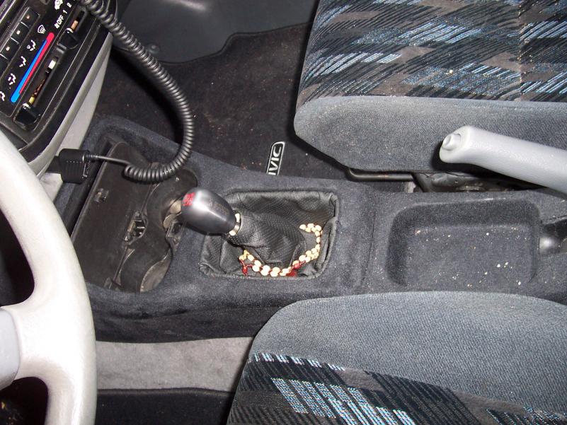

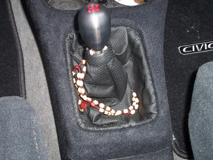

Save your seat rails on your stock seats though, on my EK i had to use one Integra seat rail and one stock seat rail per seat. have you looked into flocking the interior? it's a trend that's really starting to take off in Japan. i'm working on flocking my EK interior, it really adds a touch of class to your plastic bits. i'll post a thread on it soon, i don't want to jack dontoh's thread. solid black seats with red stitching would look dope, black seats with red inserts would look dope too, just depends on what you want.

flocking?? you mean covering the plastic parts with fabric? that looks pretty sick, i might have to try that haha

it's a quasi-fabric i guess. it's a bunch of little tiny fibers shot onto a glue-covered surface, in the end it looks a lot like suede. make sure you get color-matched glue, otherwise it looks stupid and not thought-out. i got my stuff from a Woodcraft store, no one in central KY or Cincy does it professionally, so i'm rollin DIY. in the end the interior will be black with white accents, i took my interior inspiration from a Maybach.
