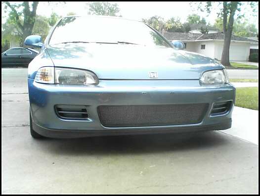

I made a wire mesh grill for my 94 EX the other day. It was a pretty easy mod, and does a lot for the look of the car. I had a bunch of square wire mesh from when I did a cold air mod on my 02 Z06. Here's how i did it.
1. Removed Front Bumper (5 screws on top, 2 on each side, 2 10mm bolts underneath)
2. Cut out exsisting grill with Dremel Tool with small cuting wheel.
3. Sanded rough area around grill, cleaning area that the grill will glue to.
4. Measured and cut screen material.
5. Formed it around bumper whole, cutting off excess.
6. Use Plumbing grade adhesive/sealant to affix screen to bumper.
7. Duct Tape over glued area to insure it sticks
8. Re-attch bumper
9. Step back and look at the sweetness!
It took about 1.5 hours. All you need is some screen material, dremel, tin snips/wire cutter, sandpaper, all purpose glue, and some basic hand tools. Here's how it came out.
I'll probably end up doing the little wholes on the outside, depending if i go with fog lights or not. [sm=icon_cheers.gif]

Old May 12, 2006 | 08:30 PM
Vexorg's Avatar
Joined: Apr 2006
Posts: 79
Default RE: Made a Grill For the Civic!!!!!{PICS}
I was thinking about doing the same thing after reading these guides
http://forums.evolutionm.net/showthread.php?t=77508
http://www.nepthys.com/artofrally/mods01.html
Old May 12, 2006 | 09:45 PM
x2100's Avatar
Posts: 190
Looks good!
I bought my car like that, but I need to change the mesh
Old May 12, 2006 | 09:50 PM
mill$civic's Avatar
Posts: 8,469
nice..looks really nice, very clean,i want to try somthing like that on my car but dont want to cut out the plastic, one day when i got nothing to do ill try putting it over top and see how it looks
