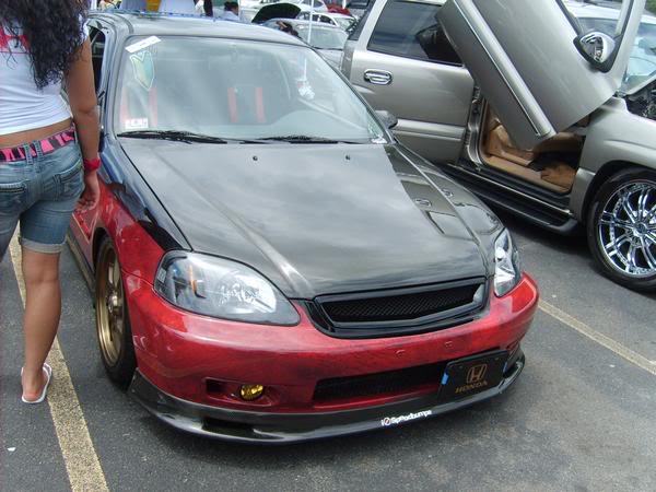

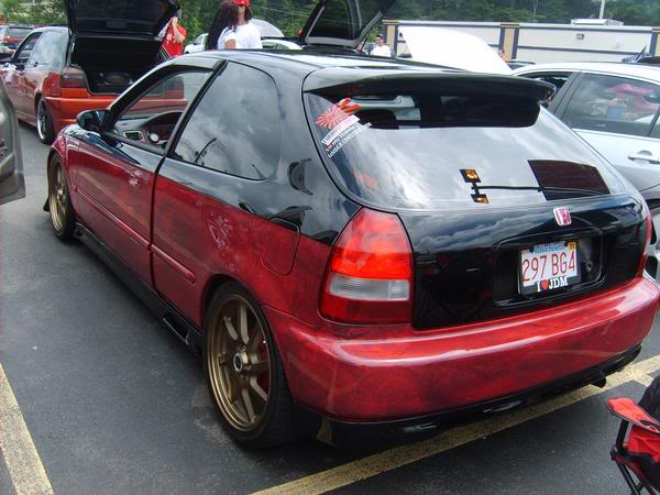

sup everyone, i went to a recent car show and i saw a black n red civic, and his paint job was one of a kinda because i had never seen a car like his.
his paint job lookd like a Marble blend between black and red
so pretty much does anyone here know how to create this effect? when i talked to him he sayd u play with the a plastic bag as the second base coat heals sand u get the above effect, but i tryd today and a sheet of metal and didnt look anything like that, anyone familiar with that technique? or know any sites that can explain it?

you can start with a black base. Then put one coat of white or silver and use your plastic bag to make the effect you want on the silver or white, the more you rub the smaller the texture peices. Practice with saran wrap, trash bags diff. things to get the look you want. Then use whatever color you want but in candy and spray over that. I
