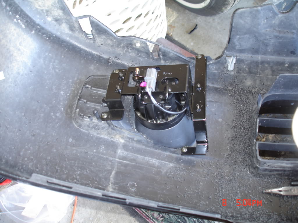

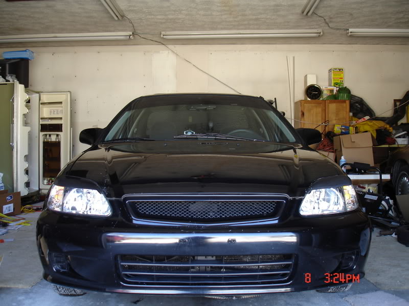

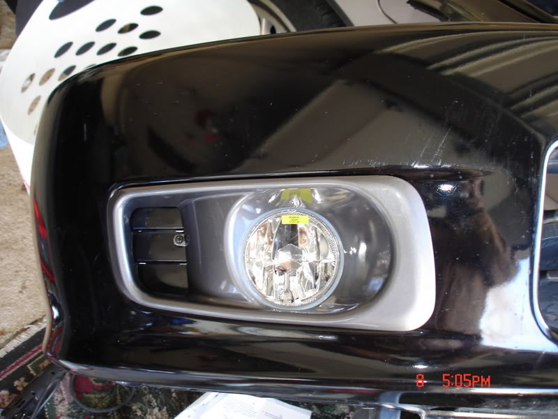

well after ruffly 3hours or work.... finaly got them on and worken..... so far LOVE EM BUT i need to buy some 6K HIDs for them to match my headlights next
tho it was alittle harder than i thought it would be.....

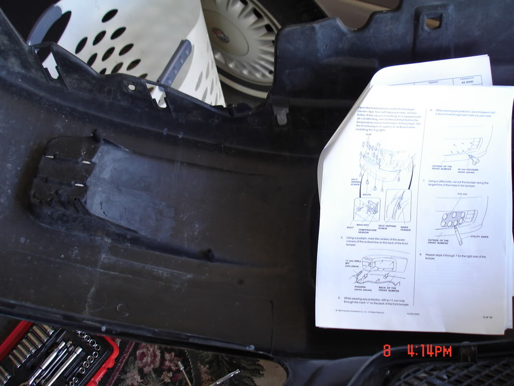

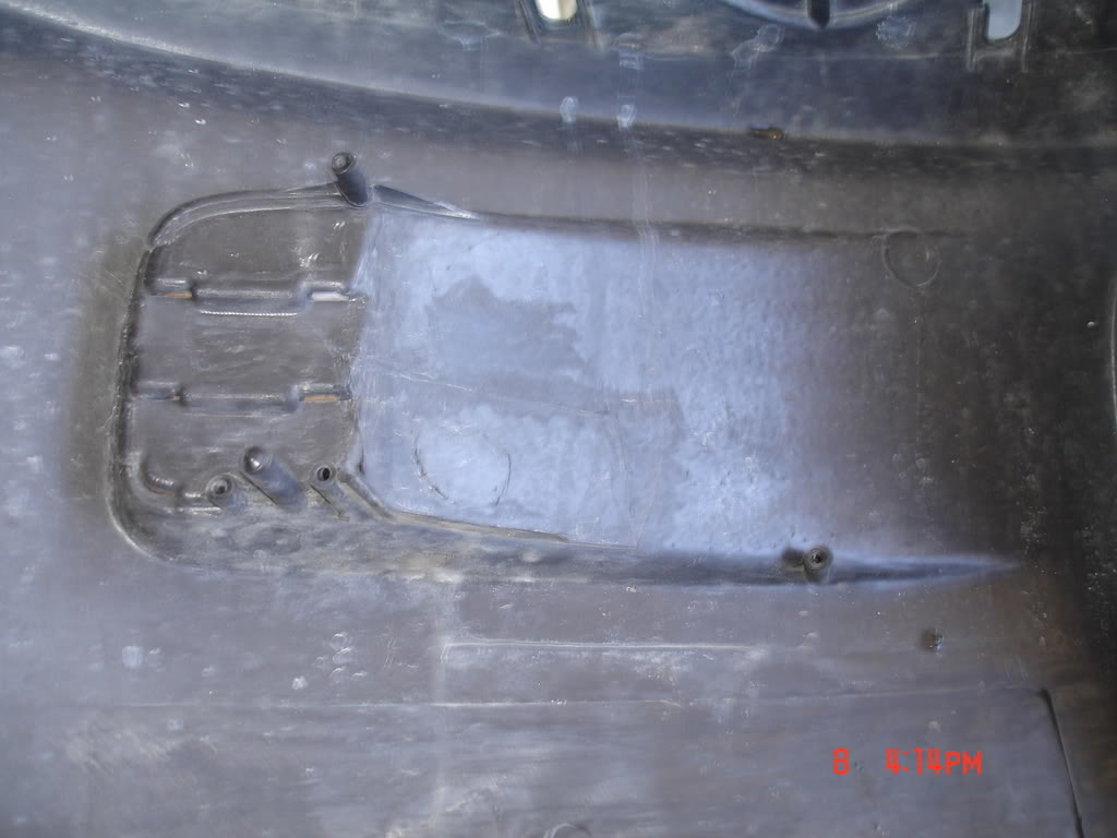

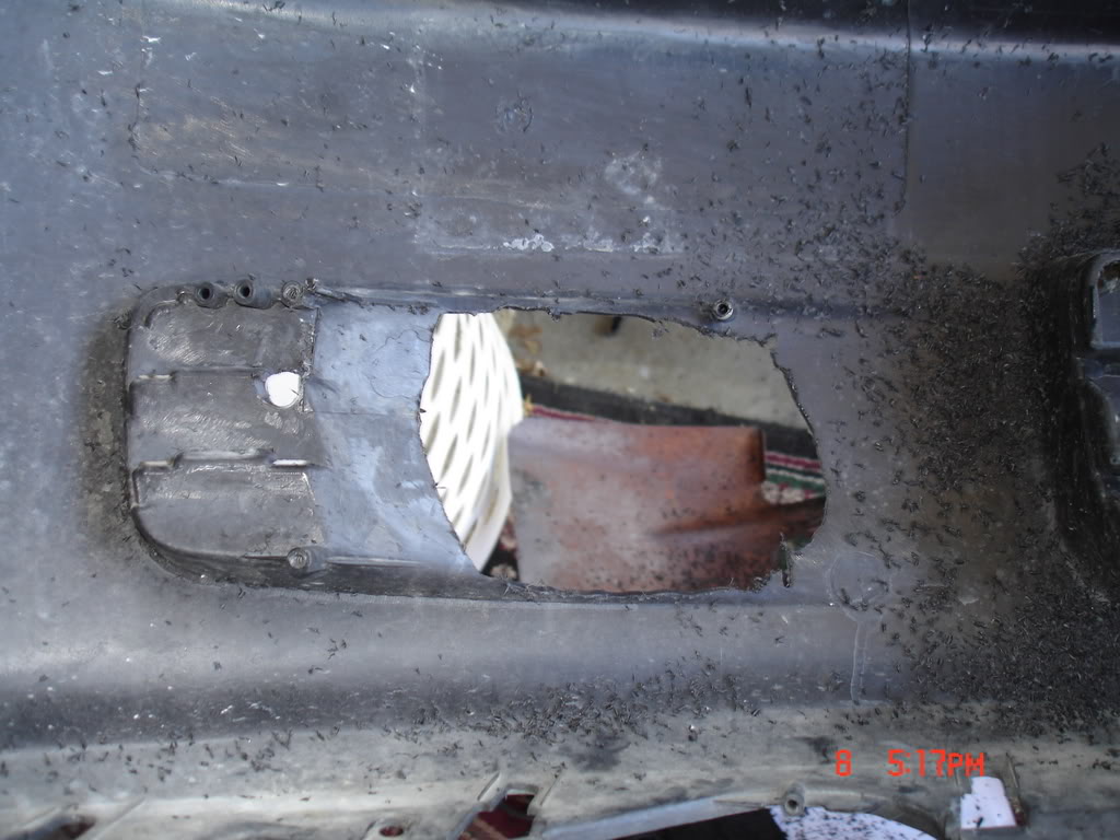

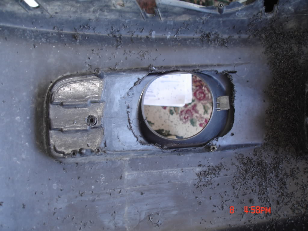

mainly due to my civic has been wrecked and front bumper wasny OEM.... so unlike the oem bumper that says it was indentations on the back side for where to cut BUT mine didnt
so it was preaty much... cut alittle, test.. and cut alittle more till i had enough out for the fog lights and the bezels..
and the inside fog light wire under the dash was a HUGE PITA!!!!!!!
finding that sucker took forever!!!
thought id post up a few pictures for people that want to put them on thier ride.....
and after i cut the first bumper hole the second one was realy quick.... i just used a dremel. turned out preaty easily..

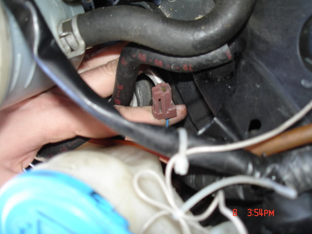

AND THE TWO WIRES THAT PROBABLY GAVE ME THE HARDEST TIME!!!
under the hood... preaty easy to find.... its between the windshield washer tank and the cruise control box... i took the CC unit out to get to it easier...

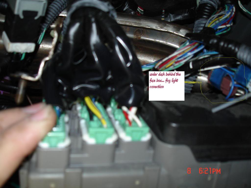

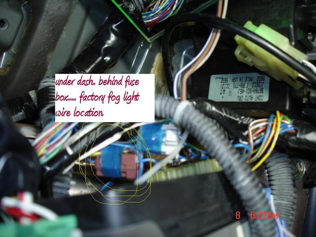

AND THE WORST WIRE TO FIND!!!!!!!!! UNDER THE DASH BEHIND THE FUSE BOX....
ITS THE BROWN conector, with 1blue WIRE..... i looked for this dam wire for ruffly an hour or so!!!
the odd part is..... WTF are all those other unused conectors under the dash for.LOL i found at least 3 other conectors taped up with blue tape not going anywhere!

i think someone should put the pictures of the conectors in the DIY area...... cause im sure im not the only one that has or will have problems finding them!!!!!!!

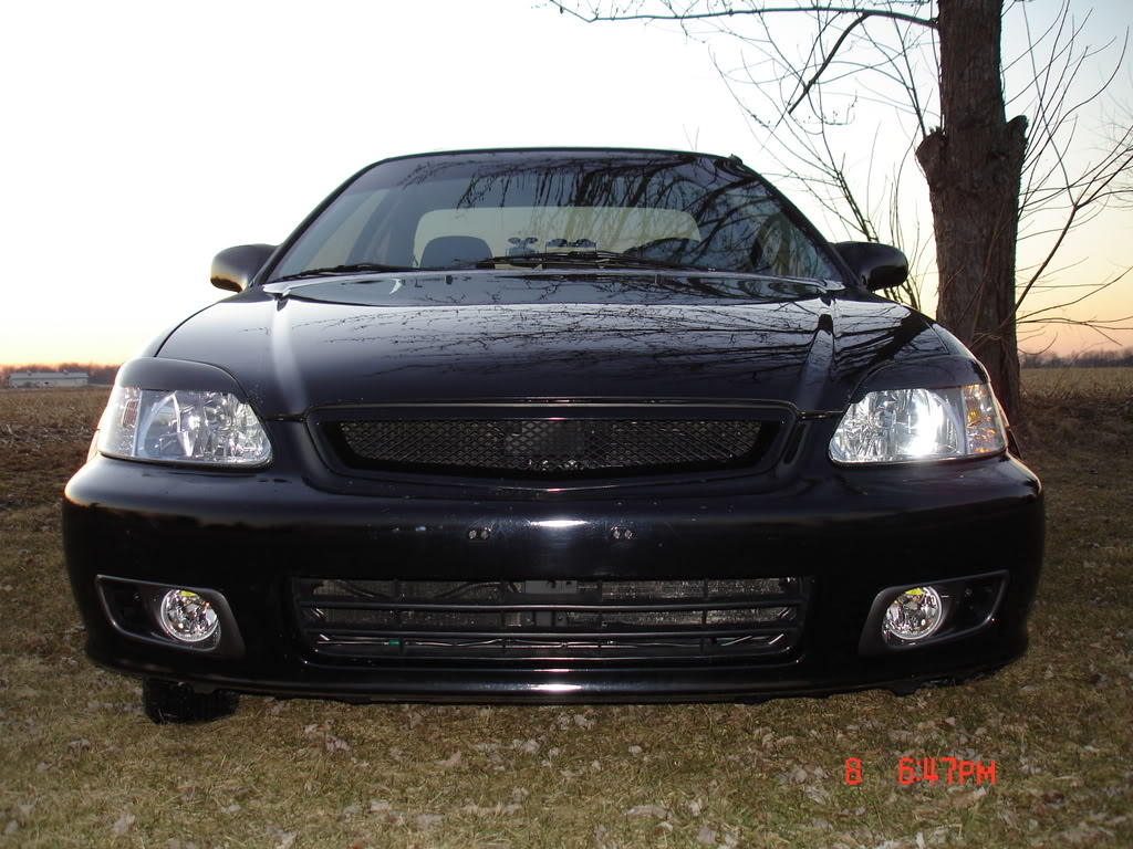

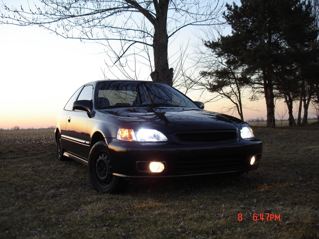

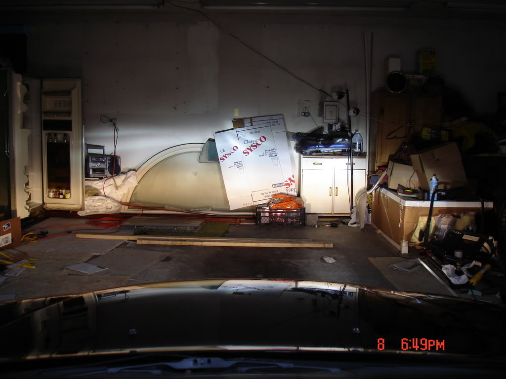

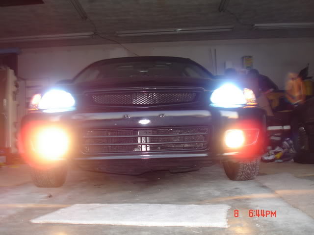

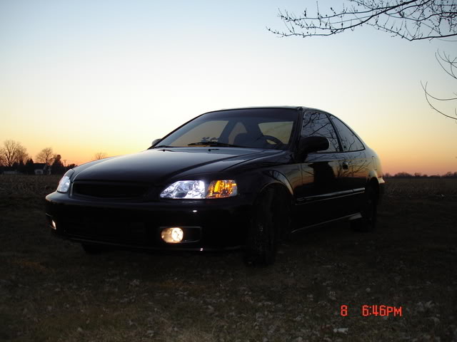

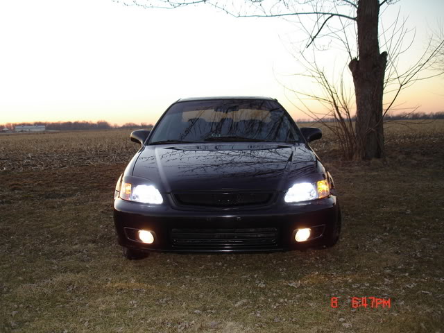

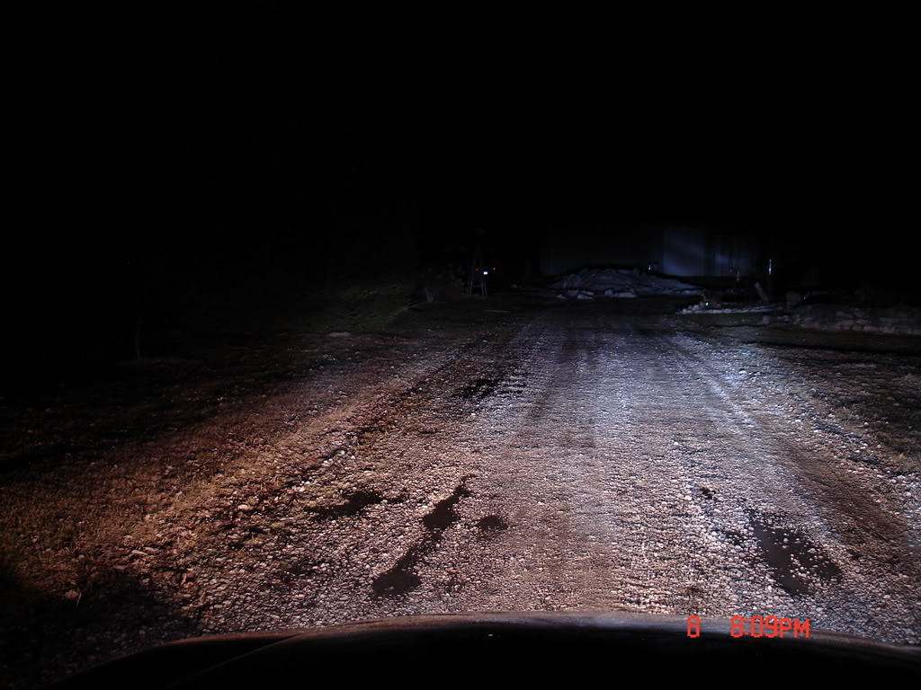

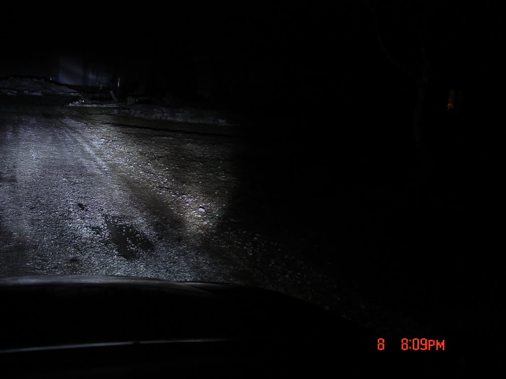

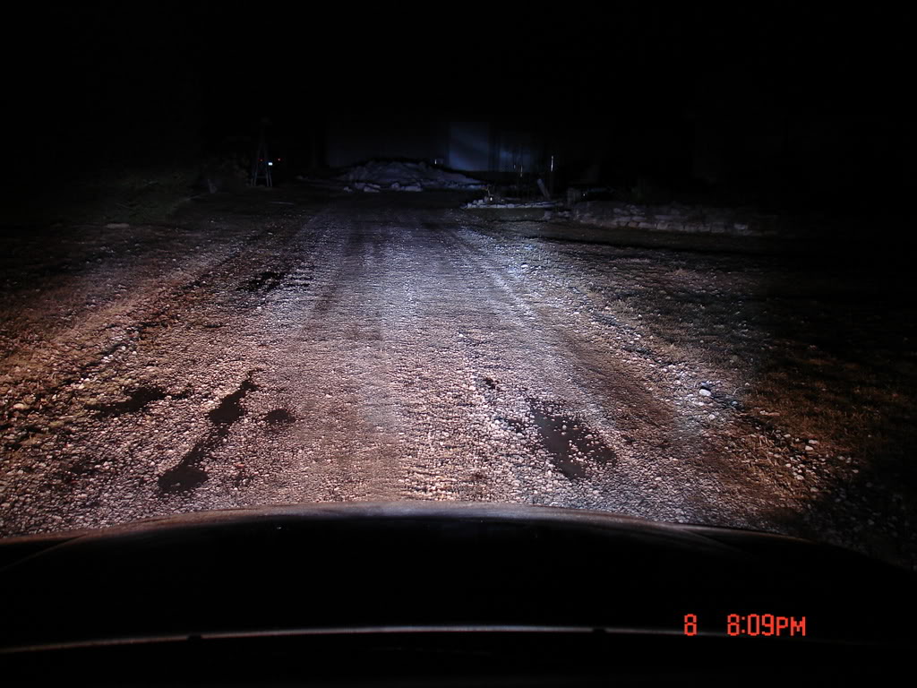

also a few pictures of WITH the fogs and without them...
helps alot at night so far!!!!!
