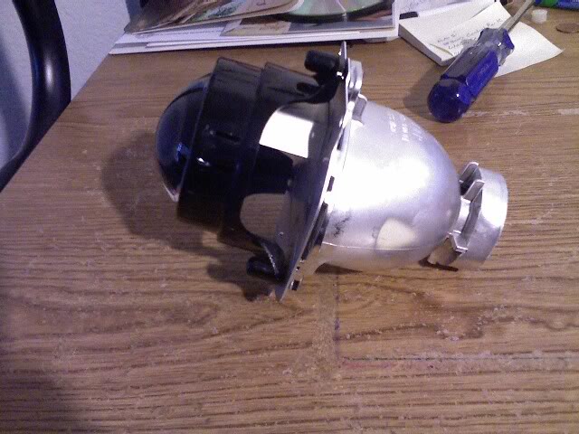

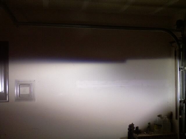

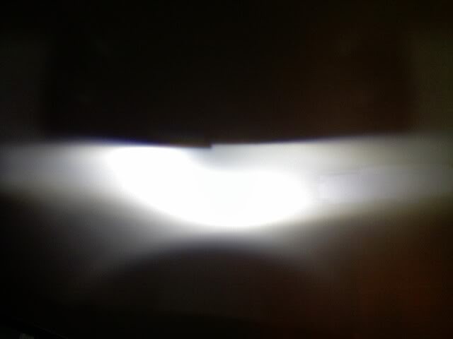

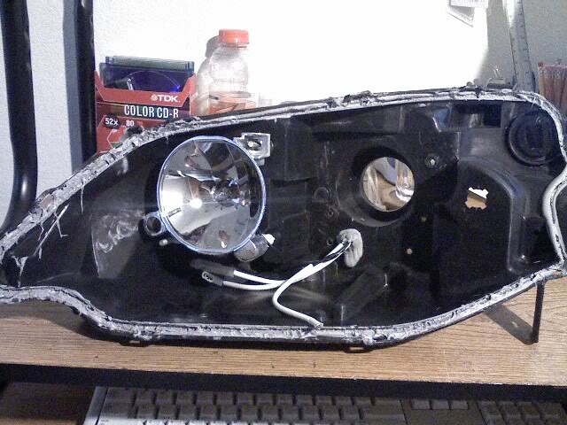

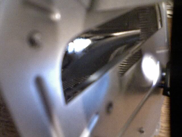

Ok here is what I got so far
Size:  86.1 KB Name:  SideProjector.jpg
Size:  57.9 KB Name:  Photo_111807_009.jpg
I think I just need to buy longer screws to put it in the correct position.

wow those are some small pictures! i cannt see jack!

BTW, how did you take your headlight apart? In the oven? I want to do the CTR style, but im so worried about melting the headlight.
Old Mar 21, 2008 | 02:18 PM
Default RE: Projector Retrofitting
ya just bake em apart....
https://www.hondacivicforum.com/m_52987/tm.htm
tho i put mine in for abotu 3-4mins that way the glue is softer and comes apart alot easier so you dont have to pry on the headlights as much..... just a razor blade and a few small flat screw drivers and its a breeze to bake them apart... BUT the hardest part is keeping the glue crap from going everywhere! its some extremely sticky stuff when warm! like thick chewing gum!
