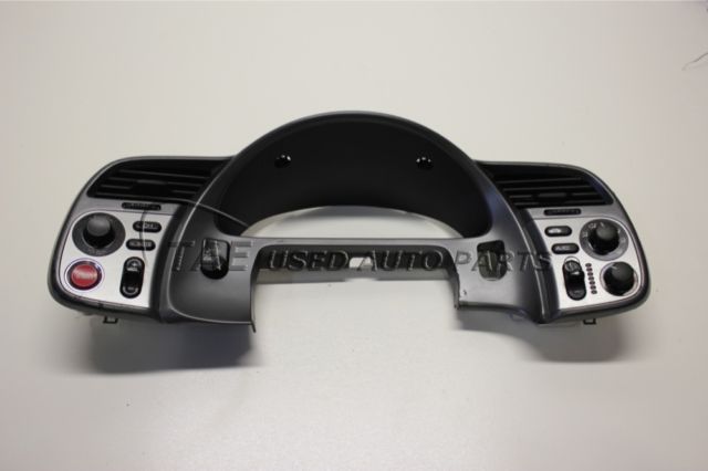

has anyone heard or have seen an s2000 dash cluster that fits on a 97 civic coupe would love to try it out but dnt want to waste time or money?? the one shown on pic... i kno the acutal cluster dose fit...

Nothing fits. It is all custom. Google search would show exactly what is needed.
S2000 cluster
**** load of wiring work
Ect converter from modifry.con
Speedo healer for mph to show up
Custom mounting work
It also has to be mounted at the correct angle or you might have trouble seeing the lcd screen correctly, especially during the day.
I have seen some very clean installs, but people end up spending like $450+ when all said and done. Not worth it IMO.
