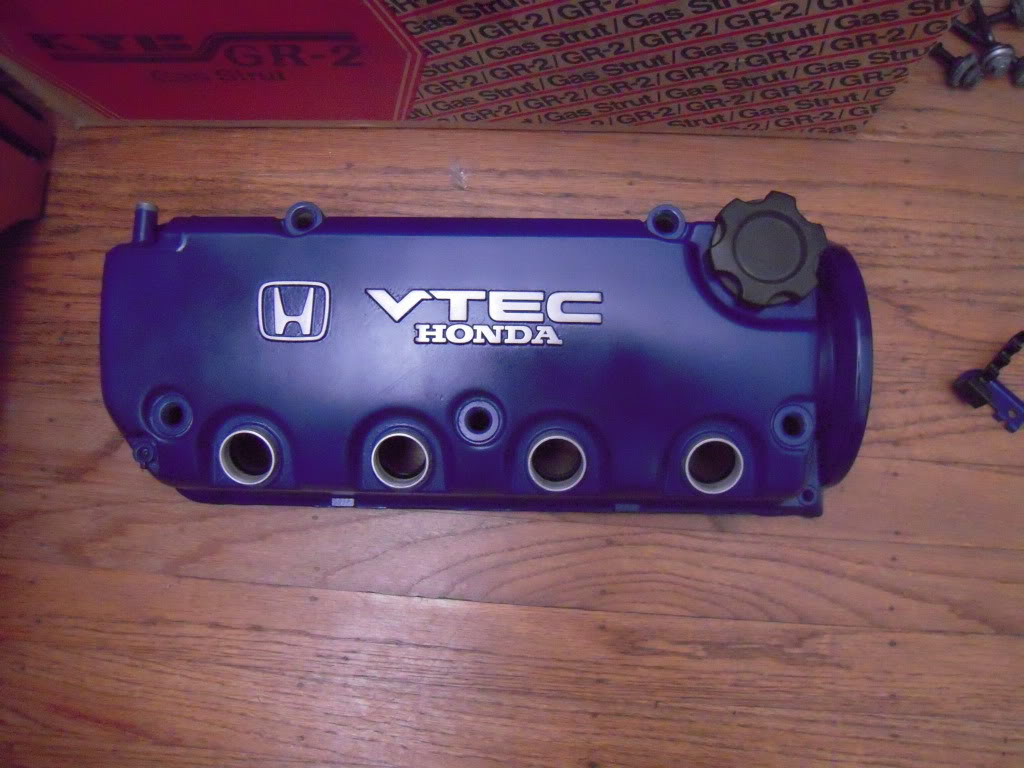

yeah if it is not to bad wet sanding will work out fine. It may not look all shiny but as long as its smooth it will look good. Here are a few pictures of mine. You can also look in my project thread to see how i did them.

(cronin's post) MMMM.... wrinkle black. Y8 VC? And what color is on the Z6 VC? Looks like a nice shade of blue. Almost looks like Electron Blue Pearl.
I forget what color the blue is, im at college and the spray paint is back home so im not sure. But yes that wrinkle black is from my old Y8 and is currently sitting in sfgiants engine bay
