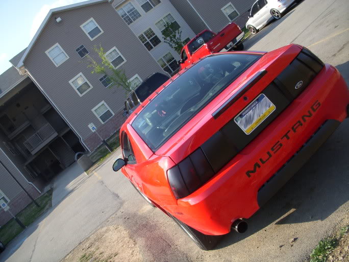

My vote is spray it with VHT Niteshades. You can get it exactly as dark as you want it, and it's something along the lines or $12/can.
I'll let the pic speak for itself. $15 in materials and about 2 hours' time.

It goes on fairly evenly, but I'd recommend doing thing coats. It'll take a few coats to get the whole light an even shade. The nice thing about the spray is if you don't think it's dark enough, spray some more. If it gets too dark, wet-sand it a little. Repeat as necessary. If you have a little experience with spray paint and wet sanding, it shouldn't be too hard to get it looking good.
