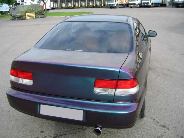

depends on the color of the tail lights, if they have red over clear then I believe they would be proper for an EX, if they're red over colors, that might also be proper... I know my DX has red over orange and clear
and yes, if you remove spoiler, it'll leave holes in the trunk lid that will have to be filled & painted

well that style is for a 4door with the ebay pictures...
but same typical color scheme... the red with lower white fully across is the more desirable taillights everyone wants...
with changing them they are realy easy.... 4 nuts on each light... thier 4 lights....
and with the spoiler forget the fiberglass and bondo....
if you want it to look right take it into a shop and have it welded up and repainted... if you just bondo or fiberglass over the holes it will just bust loose over time from all the slamming of the trunk and you realy dont want that!
