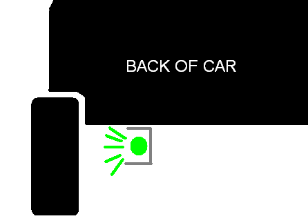

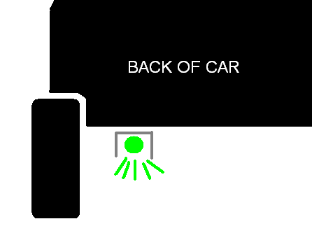

Addiction2bass i have a question for you. I know you have your lights for under your car in channels, but how does the channels sit? Is the light exposed to the ground like this:

Or is it exposed to the side like this:
