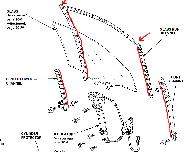

Old Nov 17, 2008 | 08:17 AM
The two rubber channels you need to lubricate are marked in red (see diagram). Spray the lubricant into the channels where indicated by arrows. The lubricant will naturally run down, coating the entire length of the rubber channel where the window slides.
Old Dec 8, 2008 | 06:29 AM
B_Ray's Avatar
Joined: Nov 2008
Posts: 56
From: Saint Pete, Fl
ya i have the same problem.
thanks RonJ
going to the store today =D
Old Dec 8, 2008 | 09:13 AM
Tiran's Avatar
Joined: Sep 2008
Posts: 263
From: CANADA!!!
I had the same problem and confirms this works, just make sure at first you apply it every day, then after a week, do it once a week. This will ensure you window will stay smooth.
And FYI, keep the can IN your car, so you don't end up like me with your passenger window stuck in fully down because of some moron friend, while you are on the highway doing 120KM/h
