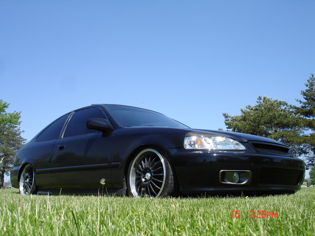

Are you talking like this (look at my rear wheel)?
If so, it's negative camber. Toe isn't as readily visible; you really won't see toe, you have to measure it. Negative camber won't destroy your tires, but toe will absolutely f**k them up.
