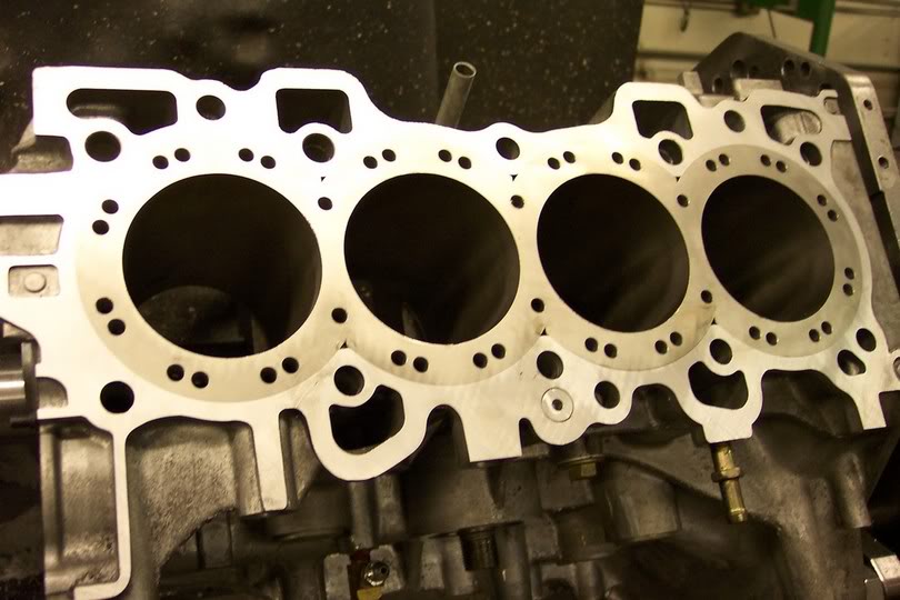

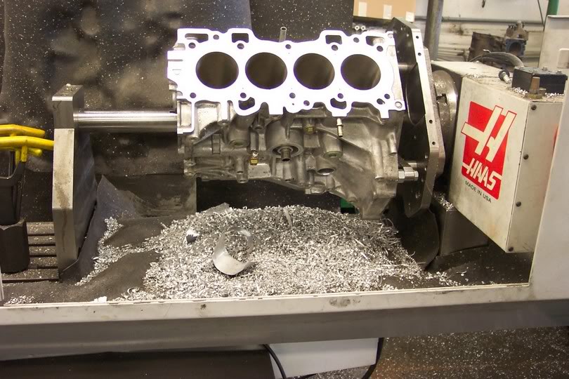

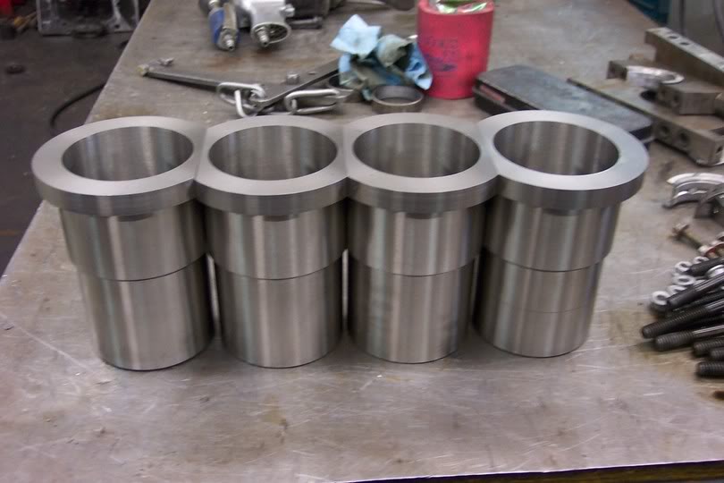

Allied Machining in St. Louis can make it happen.
B16A2 stroker motor.
Just a little machining involved.

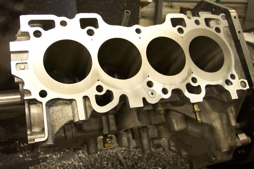

Here's a pic after the coolent holes we're finished.

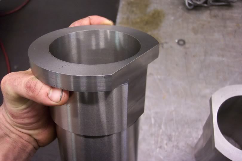

It's really not all that bad. About $550 for the sleeves and $650 or so for the machining work. Pretty damn good deal for some full press sleeves that will not drop.
