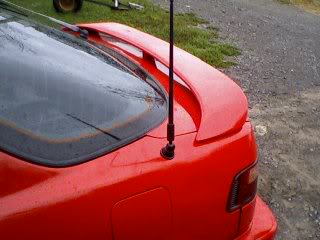

heres my integra when i got a universal replacement antenna.
