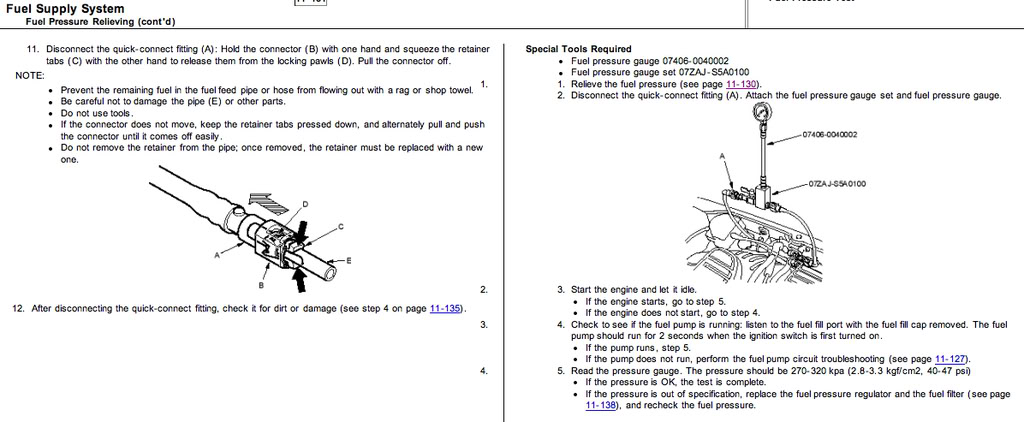

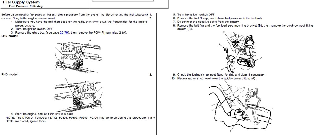

How can I check my fuel pressure?
Originally Posted by RonJ
Reset the ECU to clear the old codes so that, if the CEL returns, you will read only the new codes.
Fuel pressure = 40-47 psi
Old Sep 27, 2008 | 04:37 AM

wow thanks ronj! I'll get some help from a mechanic friend and tackle this.

RonJ- Well a friend of mine and I followed the diagram you posted and connected the gauge and the pressure stayed at 45-46 psi.
However, the car did not do the bogging/stumbling thing. I shut the car off and started it about 15 times, drove it around the block even with the gauge hooked up and nothing.
So now we are really confused. Any ideas?
