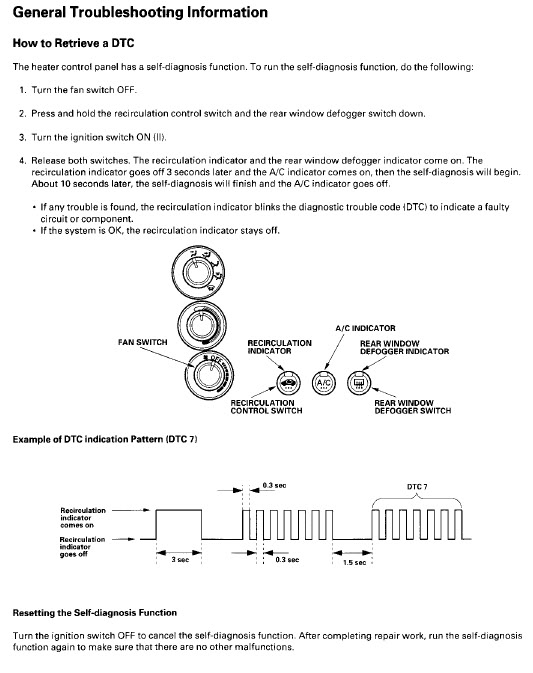

Answers to mk's questions are definitely the first step in troubleshooting the problem.
You may also want to check whether the radiator fan runs when the A/C button is pushed.
Also check whether fuse 1 or 4 under the dash or fuse 14 under the hood is blown.
Finally, try to retrieve a trouble code from the heater/AC system:
