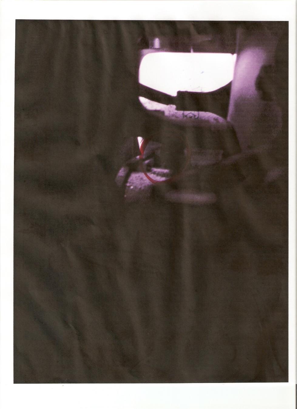

I can barely see it. It is down between the engine and the throttle body. How do I get a hand on it to replace it? See the spot circled with the Red marker...that is it.

If I remember correctly, you need to remove the air filter box, throttle cable, and both coolant hoses connected to the IACV. Thereafter, having small hands, a long pair of needle nose pliers, and a lot of patience and curse words would really help.

I've already put plenty of bad mouth on both the PCV valve and the engineers that put it there. I will work on taking the air cleaner housing off tomorrow so I can further asses the situation. I am thinking that the IACV is another thing I was looking. I wanted to take it off and clean it up like in the thread I saw on here.

.....and the throttle body. I ended up taking the throttle body off because I did not have any long reach pliers. I don't know how much dealerships pay the mechanics but they should give the machanics a bigger cut of the hourly fee the dealership charges customers. That was real booger bear just to replace a lousy PCV valve.
Thank goodness the PCV valve was almost completely clogged up with crub. I would have been very angry if it had not of needed replacing.
