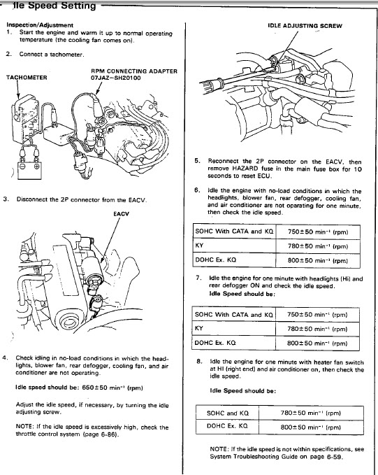

You may have a bad or dirty EACV (IACV) and/or the idle needs to be adjusted.

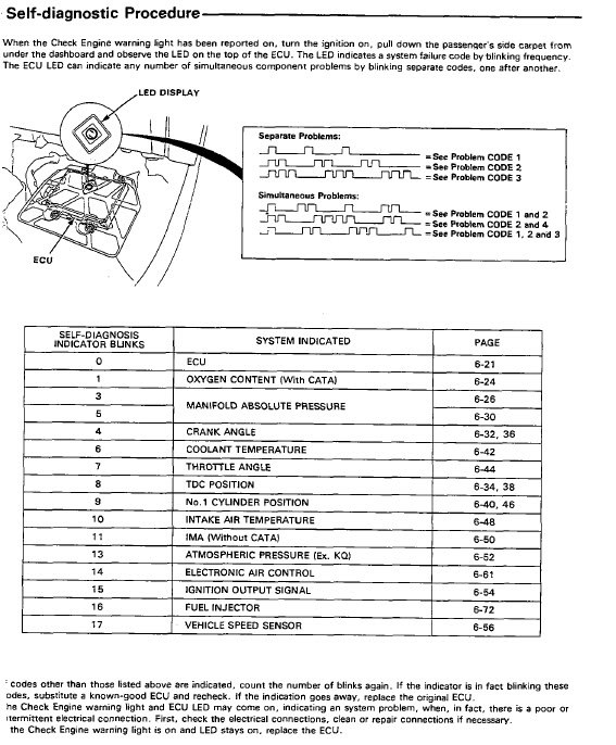

Is the Check Engine Light ON? If so, read the blinking LED code from the ECU under the carpet below the front passenger dash.

The check engine light isn't on, and it's not throwing any codes. I've read stuff other places, and cleaning the IACV has come up, so I'll probably try that. It's loud and runs like crap when it sounds like a lawnmower. Not hole in the exhaust loud, I don't think. Just pop, pop, pop like a lawnmower and louder than normal. But when everything smooths out, it's not abnormally loud anymore. I bought it on Tuesday, and the guy didn't know much about the car because it was his granddaughter's. and I doubt she had it tuned up regularly. It probably just needs some sort of regular maintenance or something. There's only 130,000 miles on it.

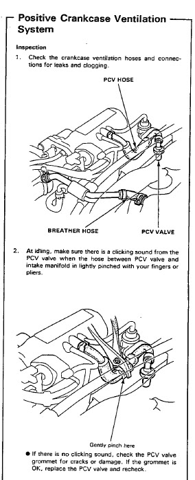

Hey RonJ just curious but does the 90-94 or any other civic year have a PCV or EGR valve? I had both go bad in my GSX Eclipse go bad and caused similar probs.
Yes, most Civics have both, so checking for a bad or dirty PCV would also be a good idea.
