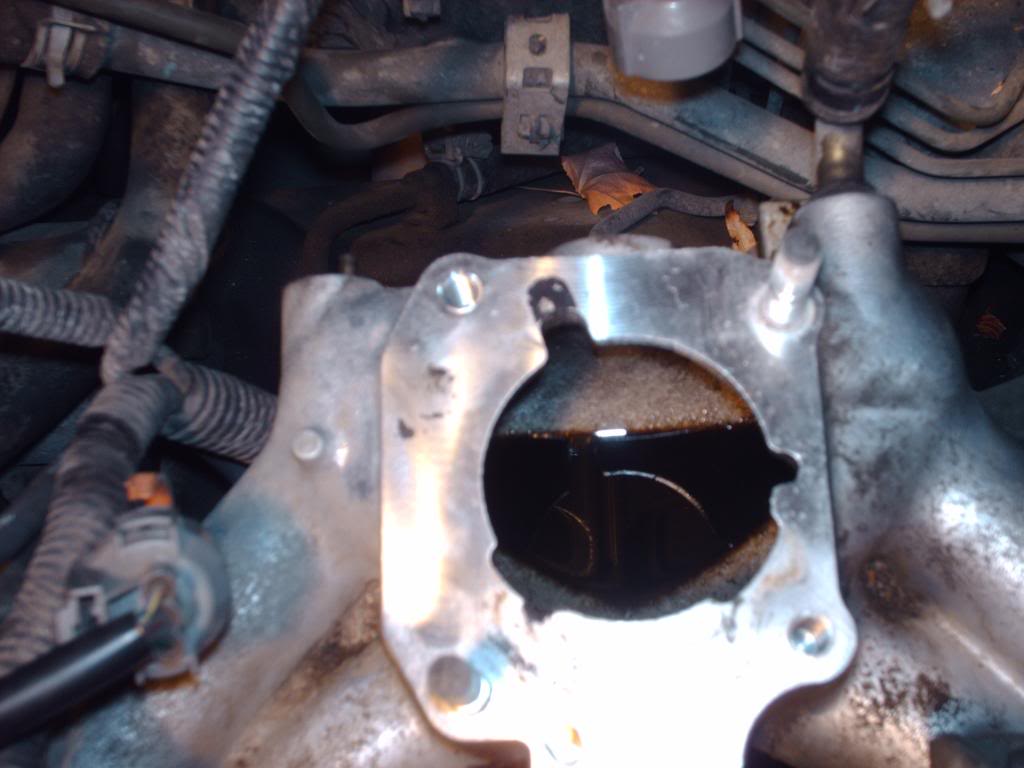

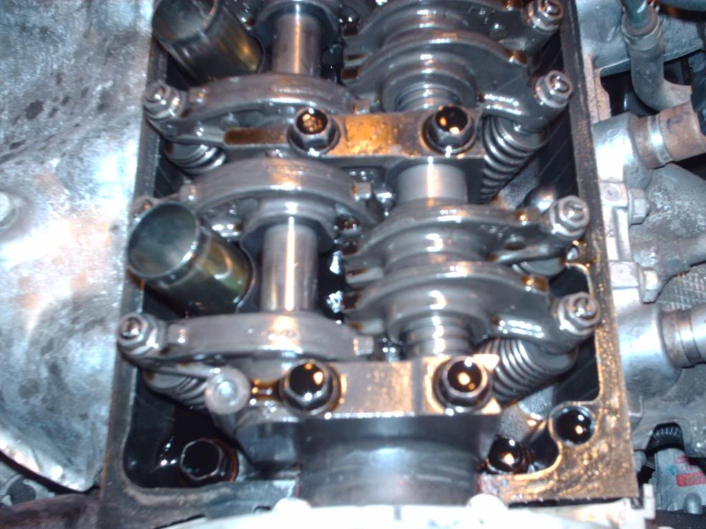

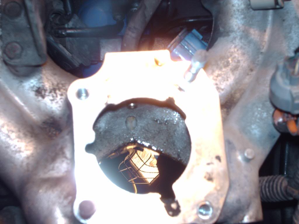

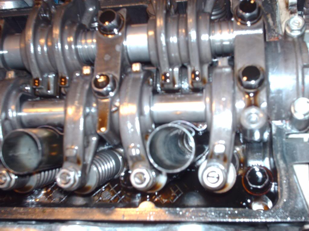

here are some pics, this is after running the motor for about 30 minutes trrying to bleed the coolant system.

I'd start by compression testing the cylinders (wet versus dry, see link in my signature) and, if dictated by the results, a leak down test.

Smoke that gets a lot worse when you floor it is usually the rings. Compression test may or may not show that. If you get any increase "wet" (after putting a small amount of oil in the cylinder), really consider that possibility. A couple of people here have reported a similar situation. They replaced the head gasket after an overheating incident, only to find the engine burns a lot of oil from bad rings. Overheating is bad for the bottom of the engine too.
Drive a little then let the engine cool, remove the spark plugs and compare them to each other. If one has a lot more black stuff or raw oil on it that is the cylinder that is burning most of the oil.
