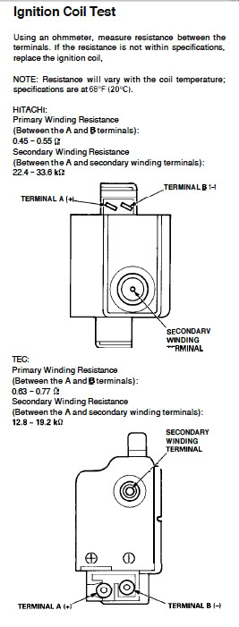

Default RE: 2000 civic lx died while driving
As you have a new ICM (igniter) and the timing belt is not broken, then I would focus on the coil and the thermostat ground wire. A bad coil would be my guess:

I forgot to mention I looked for the ground wire at the thermostat housing and couldn't find it. Does it run from the dist? I'm thinking ur right, I'm going to get a coil now cuz the stores r about to close........and I've been told the resistance check isn't always a dead indicator. I'm hopin the coil get's it. Thanx bro.
