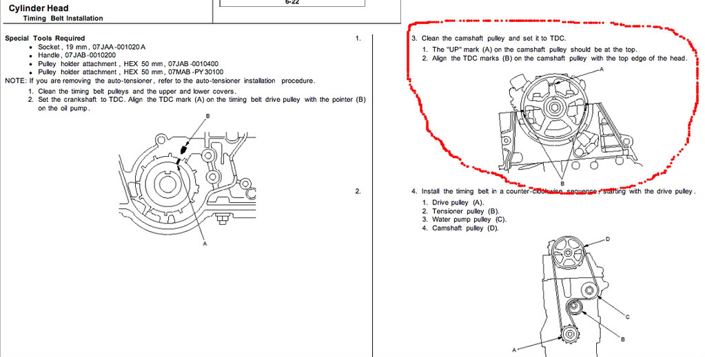

ok the spark is back but when i put starter fluid in the motor nothing happens at all do you think the car may have jumped time also how do i put it back in time if it has jummped time? i know how to remove the timing belt and stuff but how do i line it all up?
Old Aug 25, 2008 | 04:33 PM
Originally Posted by pimp1913
...how do i put it back in time if it has jummped time? i know how to remove the timing belt and stuff but how do i line it all up?
The diagram circled in red below shows how the camshaft gear/pulley looks when positioned at TDC. See diagram in my later post for how the crankshaft pulley looks when positioned at TDC.

Old Aug 25, 2008 | 04:55 PM
pimp1913's Avatar
Joined: Aug 2008
Posts: 5
thanks a lot do you think its just out of time?
Old Aug 25, 2008 | 05:08 PM
When you have spark and fuel but no start, the first thing to consider is a slipped timing belt.
**Note, if the 2001 Civic has an interference engine, then a slipped timing belt can also mean damaged valves and pistons.**
If the timing belt turns out to be fine, you next may want to check for low compression in the cylinders.

To check if the belt has jumped, it is not necessary to take out the crank bolt, etc. Simply take the upper plastic timing cover off, leave the lower cover in place. You will need to loosen the valve cover and lift it up to get the timing cover off. Rotate the crank counterclockwise, the way it normally turns, to TDC (single mark on the accessory pulley). Examine the marks on the cam pulley. If the "UP" is down, turn the crank exactly one turn counterclockwise back to TDC again.
