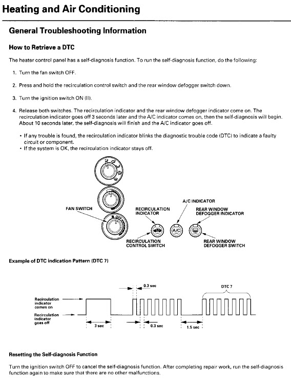

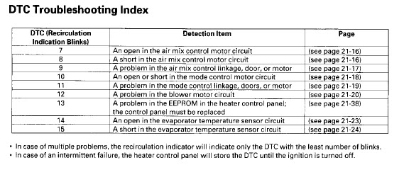

Does the cabin vent blower work? I wasn't sure whether you meant no air blows or no cold air blows from the vents.

Do the control panel test that Ron posted. If you get a code 12, get a voltmeter and do the test that I posted.
