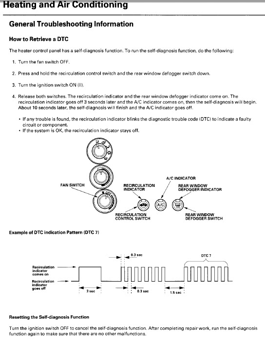

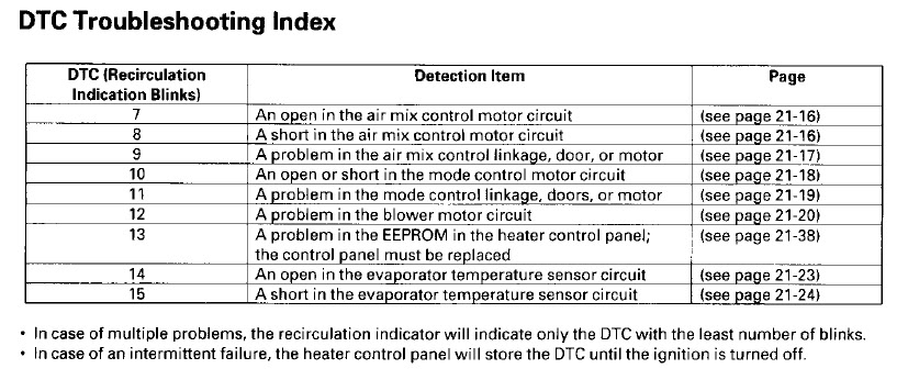

Finally, after rechecking for blown fuses under the hood, try to retrieve a trouble code for the A/C problem:
