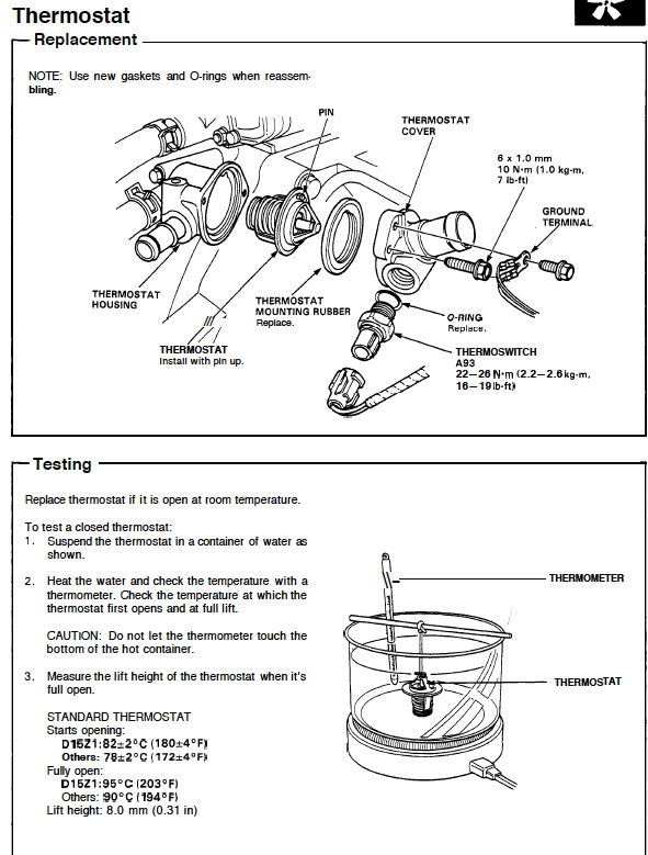

Old Mar 1, 2009 | 05:08 PM
Originally Posted by xjohnnyedge24x
how would i know if its open? cus like on a nice day the engine temp. will go up. bout 1/4 1/2 way up o.O
Just replace the thermostat or do these tests:
Old Mar 1, 2009 | 06:48 PM
mk378's Avatar
Posts: 10,023
The engine temperature should go up to halfway and stay in the same place in all reasonable weather conditions (above zero Fahrenheit or -20 C).
