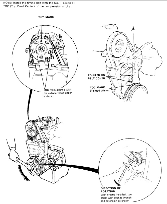

Old Jul 15, 2009 | 09:21 PM
Mechanical timing: Remove the valve cover and then the upper timing belt cover. This will expose the camshaft pulley. With the front end on stands and the transmission in neutral, you will then be able to turn the crankshaft pulley counterclockwise to see whether the cam and crank are still synchronized at TDC1.
In my opinion, it makes much more sense to check for spark and a snapped timing belt before going through this procedure of checking the mechanical timing. Just my 2 cents.
how do I get the cover off? Steps to that??
Old Jul 16, 2009 | 08:51 AM
Simple. Remove all of the valve cover bolts and lift the valve cover up.
Old Jul 16, 2009 | 03:39 PM
hamster's Avatar
Joined: Jul 2009
Posts: 8
Alright. Thanks RonJ you have been a LOT of help.
